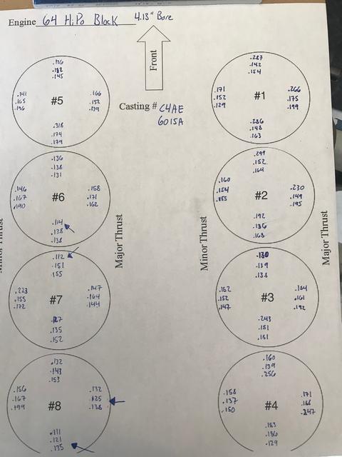

Here's the sonic sheet on ours at 4.13". I deemed it too thin to do anything demanding with, still usable street block though!
Is this block already at 4.130?  That's pretty thick. You could go .025 out for one more bore with one sleeve. Barry says as along as you have .100 finished it's fine.

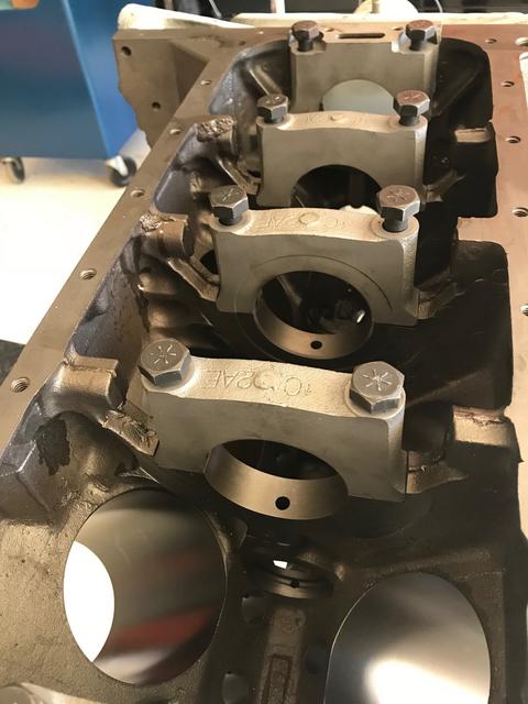

Keith, yes it's rough bored to 4.130 and need to be finish honed. I wouldn't use this block to cross bolt and build a stout street/strip engine. Will more than likely end up cross bolting it, put a 4.25" crank in it and put it in my Dad's '63 Galaxie street car.
Here's a picture of the block the sonic test sheet came from. Told you I take a ton of pictures.

That's good to go. Barry Rabotnic builds them when they are at .100 or more.  Cross bolt caps and align bore will be another 600.00 +. I saw a set of 427 caps on Evilbay a few weeks ago.  However, .100 is plenty thick, even for a performance build. I think many blocks are thin for reasons besides just plain core shift issues. Corrosion in the water jackets is a huge factor as well.
