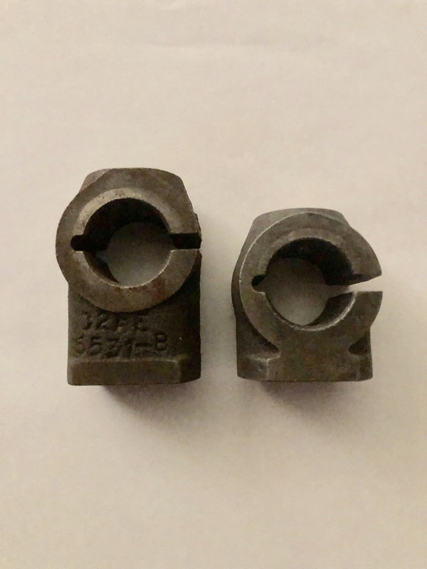

Could H/S rocker stands be Highriser size ? Have you measured different A/M stands and compared to both OE stands

HS stands are definitely not high riser height.

I don't have stands to compare. Can you measure the H/S to stock stand height and post them ?

Ford low riser stand & Ford high riser stand.

i think the hs stands are shorter than stock rocker stands because stock rocker bolts wont fit with hs rockers. they are too long,they bottom out in the heads,believe me i know because i tried it and i messed up a new set of bbm heads.the stock bolts punched out holes in the head runners and now they seep oil past the rocker stand bolts into the head causing smoke and oil consumption.i think hs stands are longer than high rise stands but shorter than low riser
