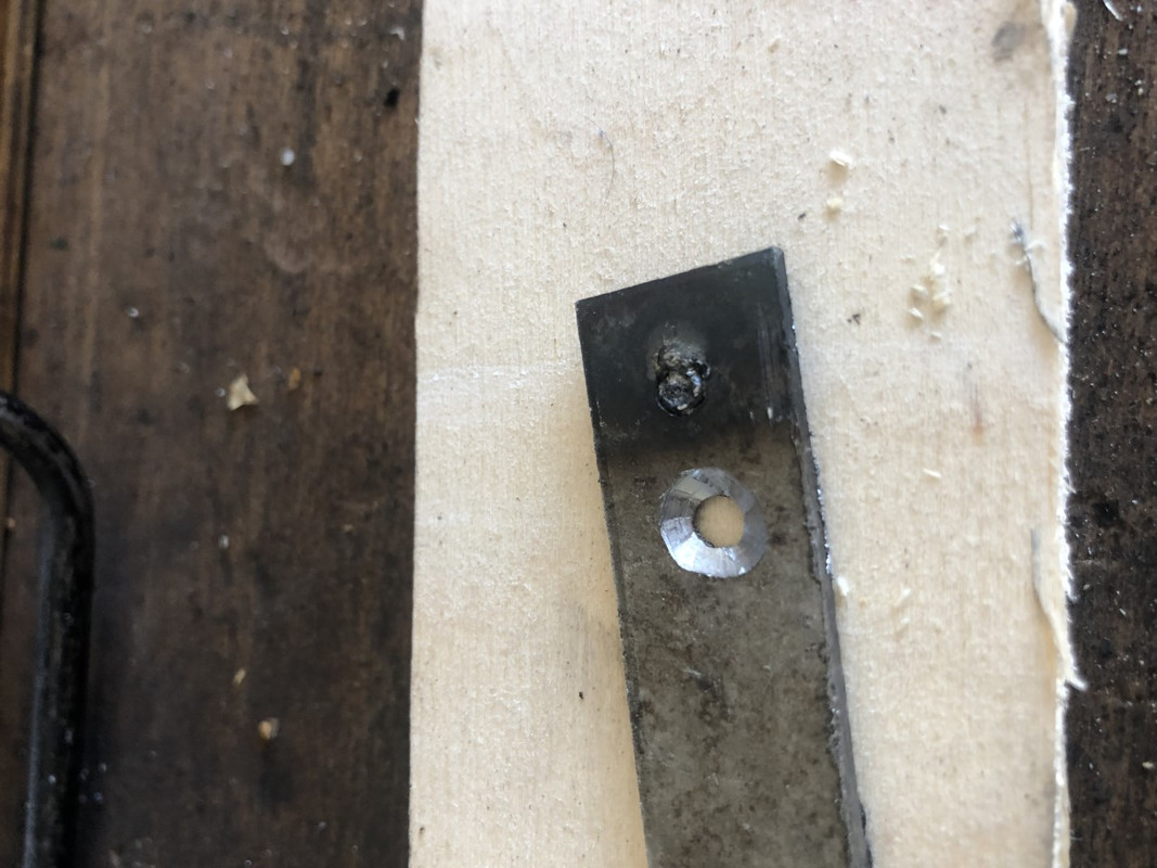

Here is how i do it drill a hole in a flat bar and countersunk
and weld it to the bolt/plug/whatever. let i cool for a couple of minutes
and unscrew it
gregaba
  • Posts: 992
Re: machine shop cant align bore block
« Reply #57 on: June 12, 2019, 11:22:48 AM »
Thanks for the ideal.
If my methode doesn't work I will give your's a shot.
Greg
