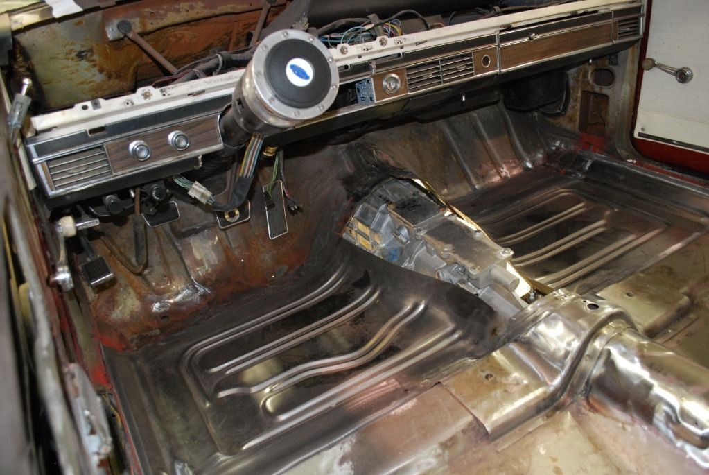

« Reply #36 on: December 01, 2012, 08:02:17 PM »
Well there's something you don't see every day...
I was so wiped from Thanksgiving weekend that I hardly touched the car all week.  Getting her back on track this weekend and I got a good look at the transmission from inside the car.  The air chisel was awesome.  It cut it fast and neat, with no sparks or dust flying around the car.
-Wade

« Reply #37 on: December 01, 2012, 08:05:35 PM »
Wow.. that sucker really is up in that tranny tunnel!  :o

« Reply #38 on: December 01, 2012, 11:25:59 PM »
I feel your pain....
Re: Galaxie/TKO
« Reply #39 on: December 02, 2012, 12:41:43 AM »
65er,
Is that close to where the trans needs to be for the U-joint angles?

Wow if your taking that much out of a Galaxies tunnel, I'm gonna be taking a bunch out of my Comets.  Now if I could just get work to slow down enough to get started ...lol.  I don't have a time constraint as bad as you but I do have to have it done before 4-27 so I can take it too the FE Reunion.   After the holidays I will start to the big get parts ordered.  I have pedal assembly, Z bar and few other parts gathered up right now.  Need to see how that stuff is going to fit with headers and other obstacles.  Incase I need to convert to a hydraulic throwout.

Hmmm. I wonder if the floors are a little different between 65s and 66s. I was able to get by with some well placed dents in the floor towards the front . I was afraid I was going to have to do just what you are doing, though. Keep up the good work! Once it's it's done it will have been worth it.  :)

   I've followed your progress and it is very similar to what I went through. I've got an article in the January 2008 newletter on the 57fordsforever.com website about my TKO swap. One thing I will tell you is after you get through this ordeal you'd do it over again for the benifits it's going to give you. Good Luck. Jim  PS
     I had to lower my z-bar bracket on the FE engine. I just slotted the existing holes in the bracket to lower it. I also had to add about two inches to the z-bar where the clutch rod attaches and I had to buy a late model clutch fork to extend the distance out from the transmission. I also made a new crossmember. But, it was worth it. I DIDN'T cut my 57 tunnel. I looked up the geometry specs for u-joint alignment and wear and measured the angle of my driveshaft and found out that I was within limits. After 34K miles there isn't any wear on the u-joints. ( it's tight in the tunnel and the fan blade is 1/4" closer at the bottom of the radiator but you'd never notice it unless you got out a tape measure)
