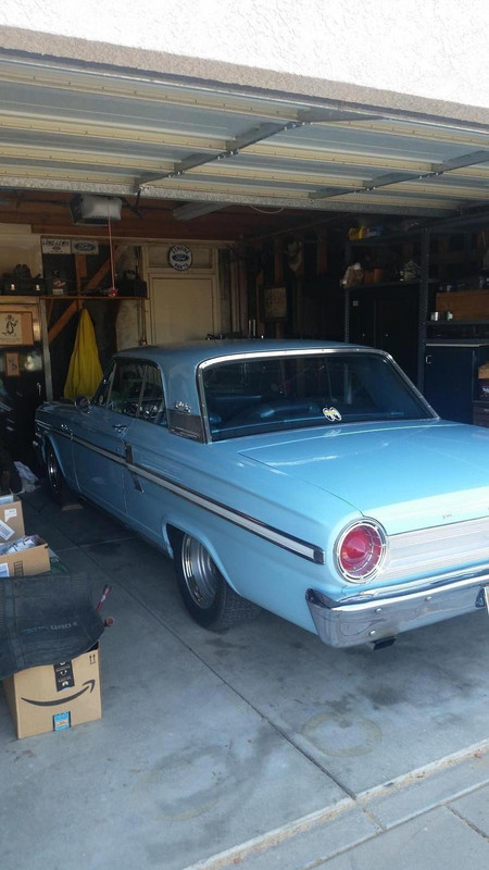

Skylight Blue (not sure how to post a picture correctly sorry)

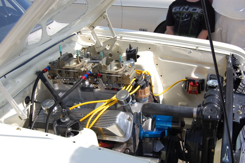

I don't own a '64 Fairlane with a FE, but I've looked at a couple real Thunderbolts, and a bunch of clones & racecars - I agree with Doug, adjusting valves shouldn't be difficult. I included a good picture of John Calvert's '64 Fairlane Stock Eliminator drag car, you can see it's a pretty open shot to get to the valves, relatively speaking. I also agree with Doug, all my hopped up FE's have been solid lifter, rarely do the valves need an actual adjustment past the initial break in time when I check them, so it's not something that should need constant attention.

Our member Greg R's beautiful '64 Fairlane Stock Eliminator engine compartment.

Mike, here's your picture rotated & resized. Nice car.

I'm surprised Calvert runs that terrible C4AE-D intake. The other one (C4AE-F) in the second shot is better. Both are legal for Stock aren't they?
