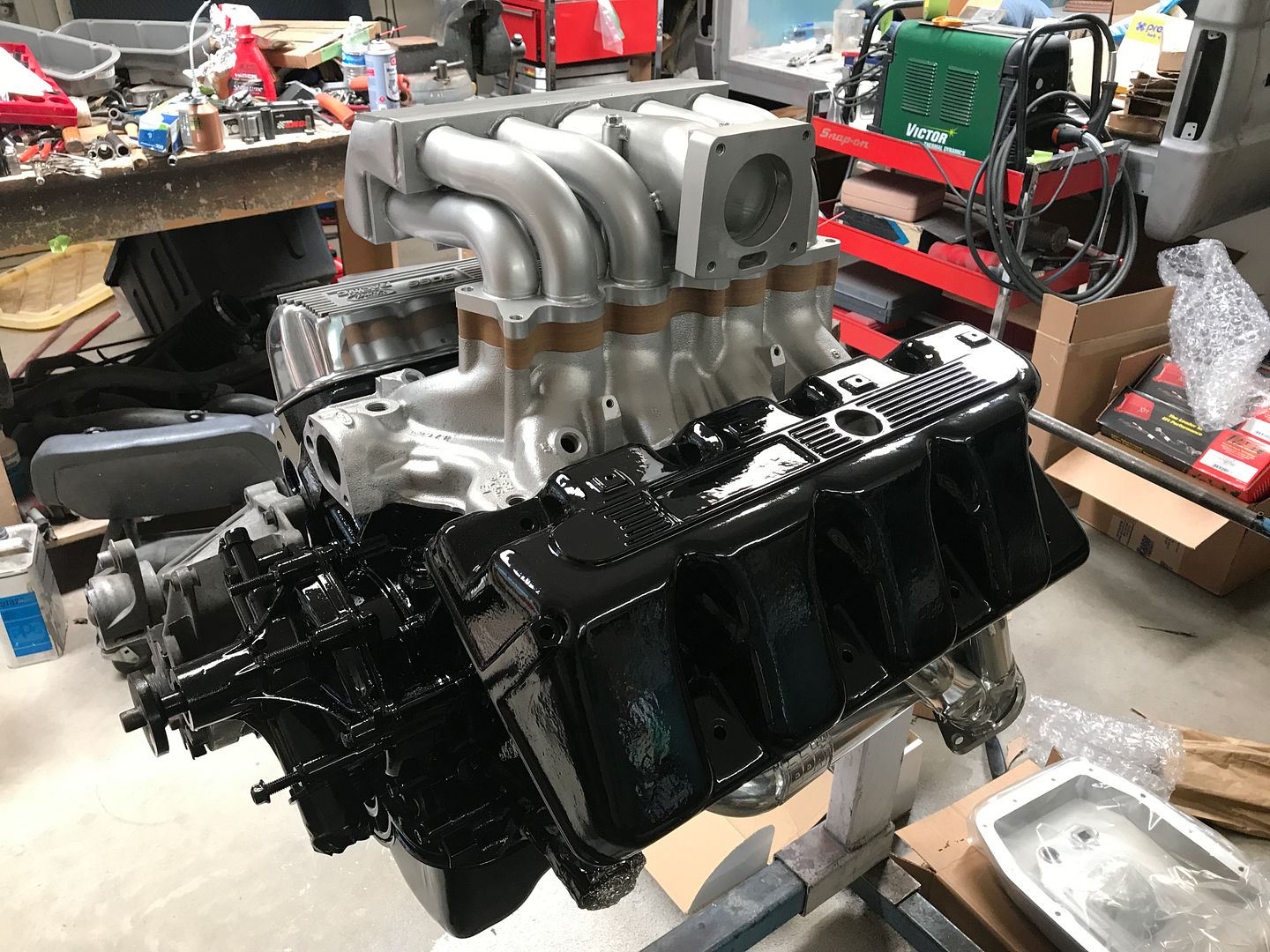

More Parts!
« Reply #24 on: August 10, 2017, 12:52:54 AM »
 :-\ ::) More parts trickling in . .

Huh.... so that's a 289.....  :) cool, good luck Randy.
Valve covers fit a small block fine. Heads should too!
