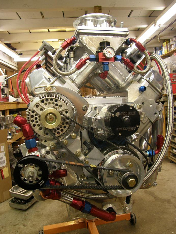

Speaking of brain churning, I’ll show you my inspiration for going this way. Even though mine is not close in power it’s something to aspire to.
This engine is to me one of the most bad ass deals I’ve ever seen. Go to the dyno session and listen to it scream. It’s an ungodly sound.
http://fepower.net/simplemachinesforum/index.php?topic=168.0
I hope the owner doesn't mind me using his picture. ::)
