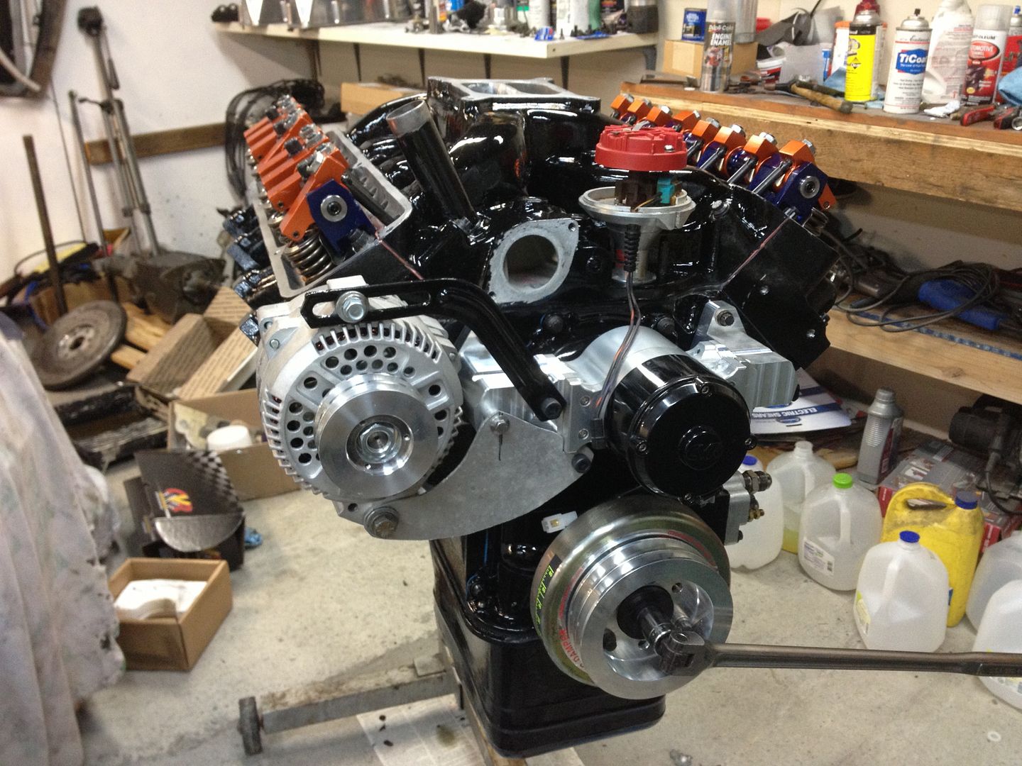

The pulleys I got at CVF Racing. They are very nice. The alternator bracket that I had was pre-68 and would not fit on Jays adaptors but he was kind enough to provide a template of the newer bracket included in his instructions. I made a flat one with a small tube for one of the bolts.
Jay, I might get a chassis dyno and for sure I am going to the track.
Here is a picture of one of the heads being worked on and a pic of the bracket I made.

Your alternator bracket looks good. I think someone here, afret maybe, figured out how to modify one of the early brackets to fit my adapters.  Earl, if that is correct could you post some pictures?  Figuring out how to modify the early brackets is also on my own list, so that people who have the earlier brackets have a solution.

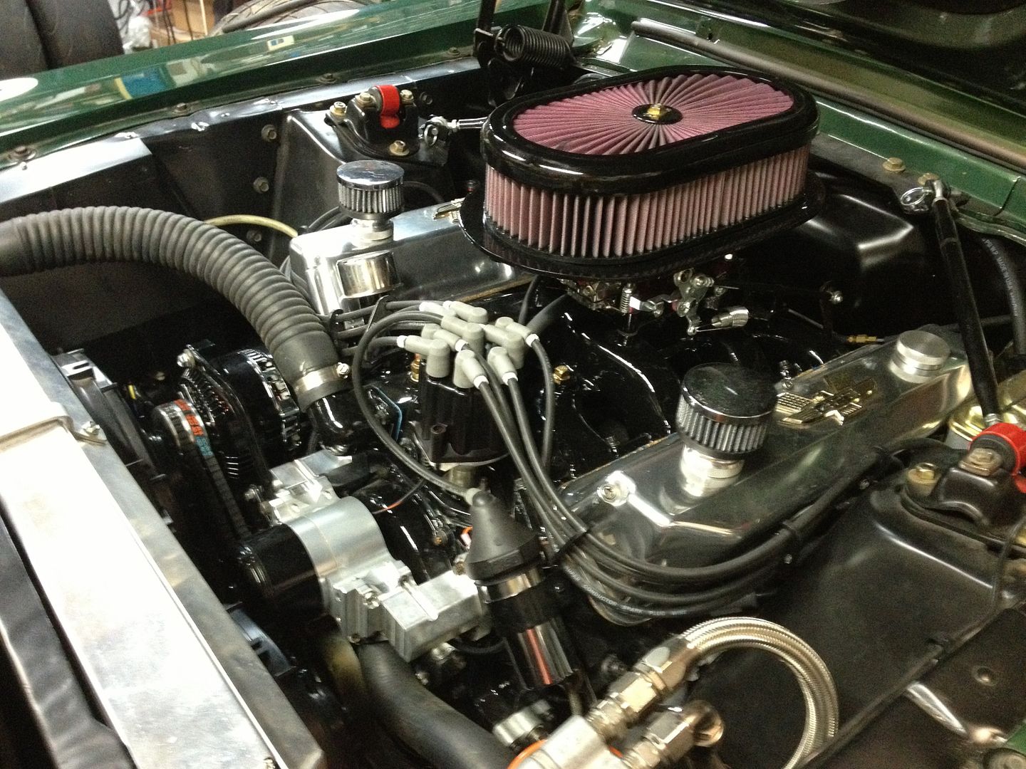

When I tried starting the engine, it had a hard time turning over and would not start. Here is the engine ready for starting.

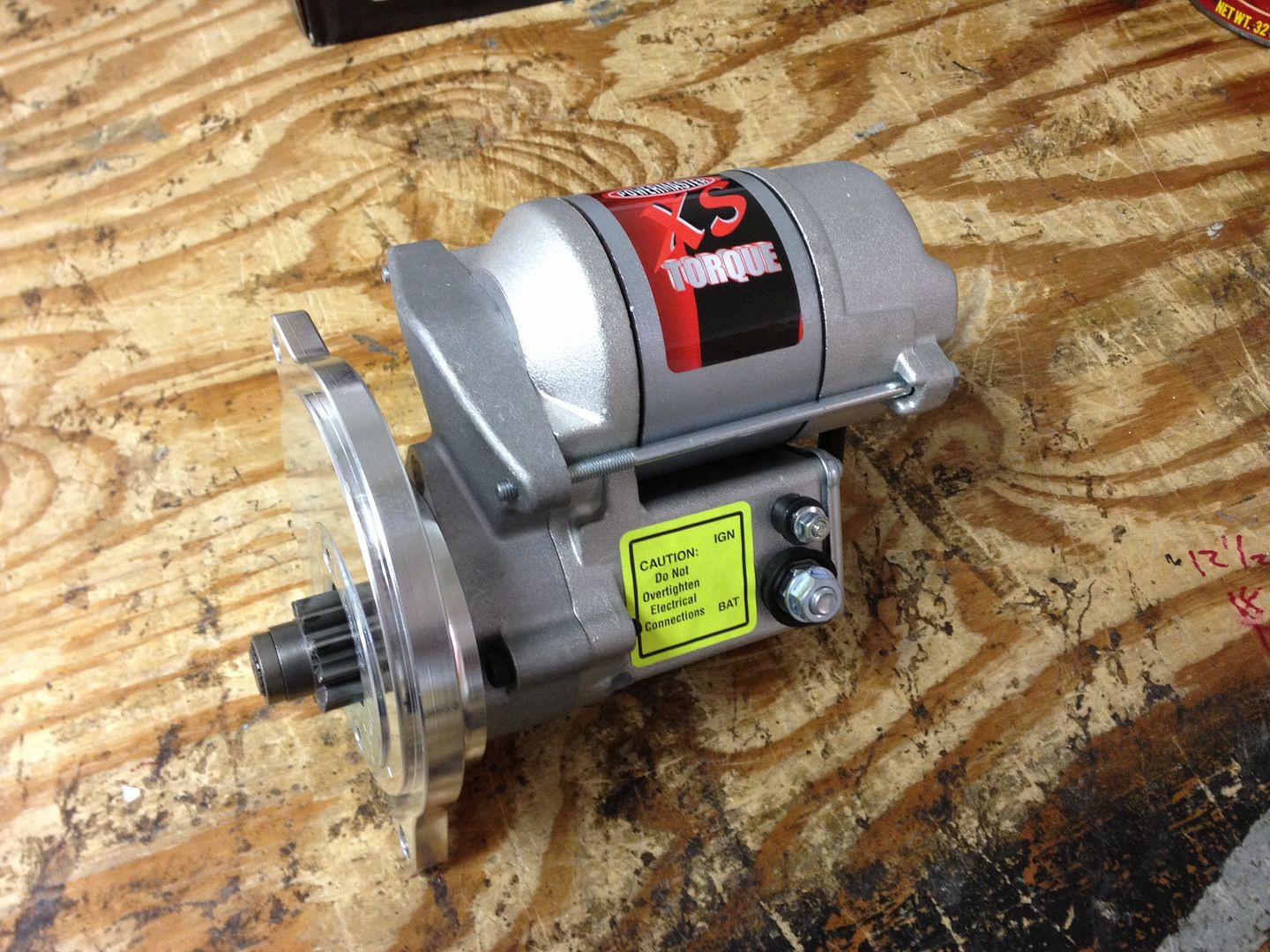

So I bought a new starter. It is a Powermaster and is only 6 1/4" long IIRC. I works out nicely with my headman headers.

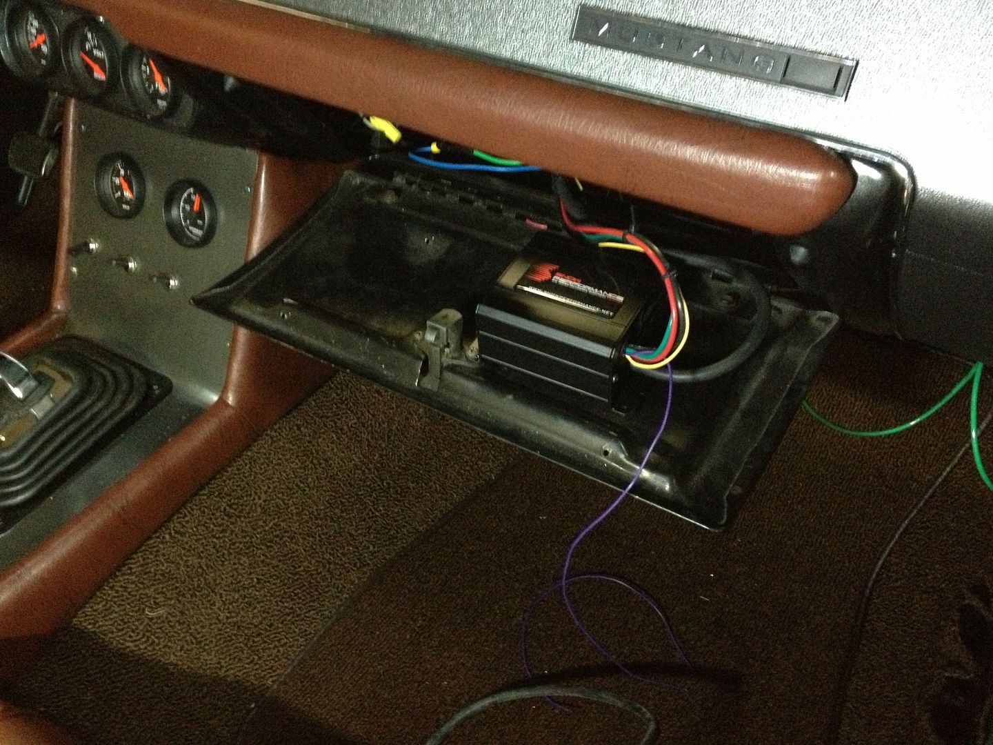

The controller in my glove box.

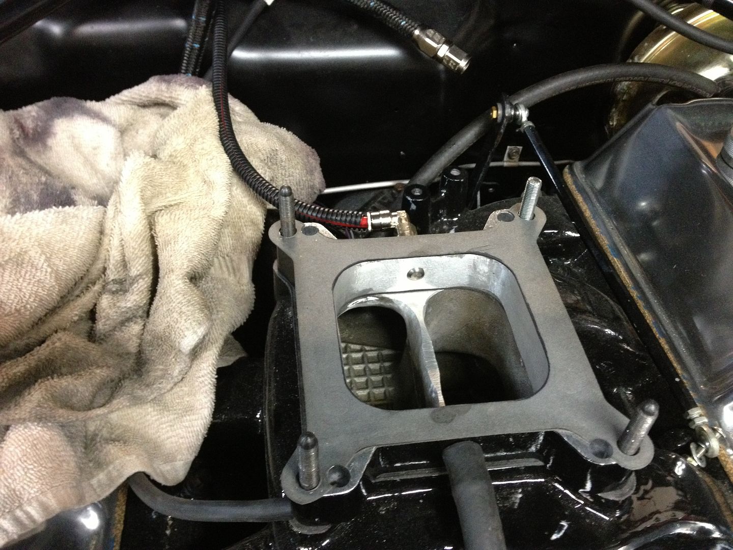

And the injector in a 1" spacer.
I have it set up not to go on until the rpm reaches 3300 and not to start injecting until the vacuum is at 6" and is injecting at full at 0" of vacuum. By putting on a 1" spacer I ended up with air filter 1" higher. Here is a pic of that.

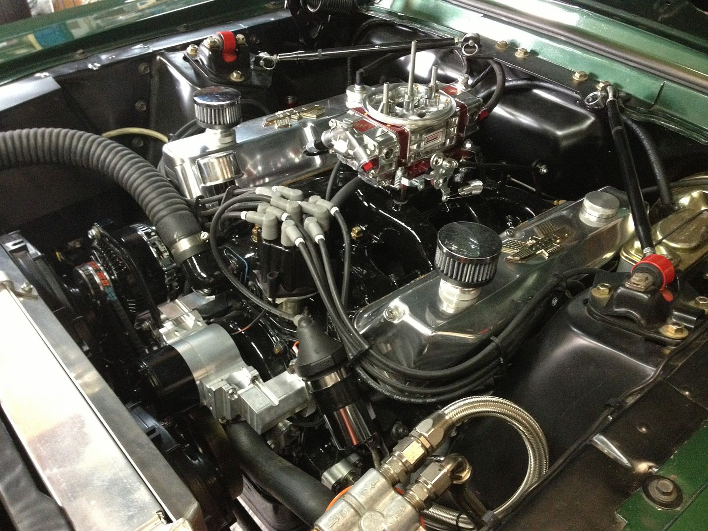

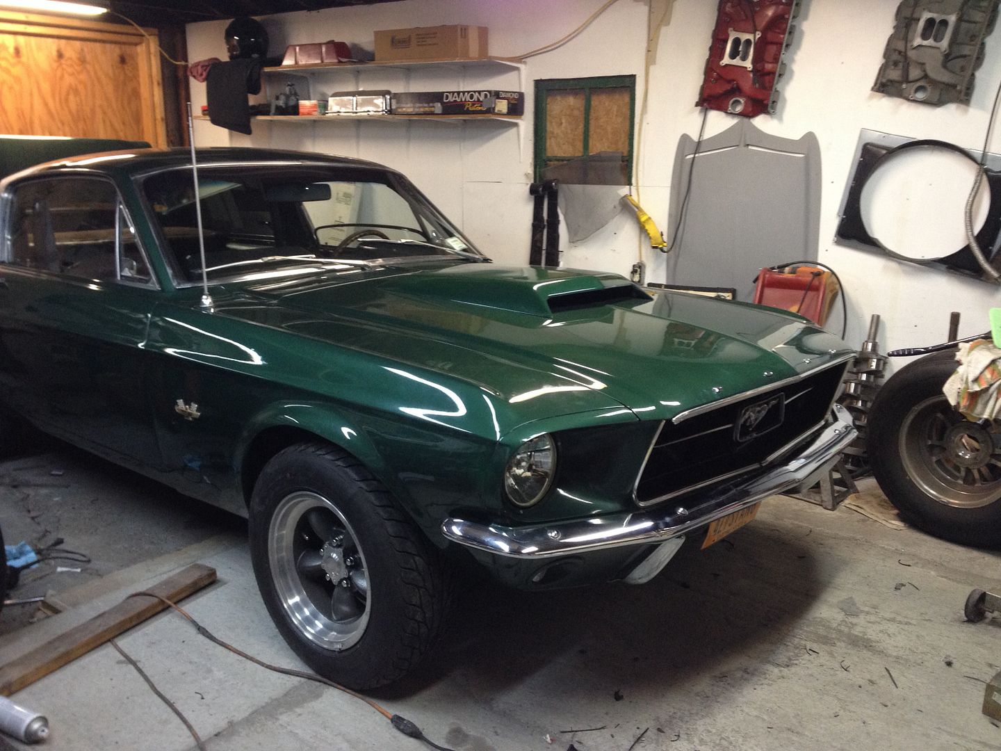

Here is a picture of what it looks like now with the new 950 carb and my modified air cleaner.

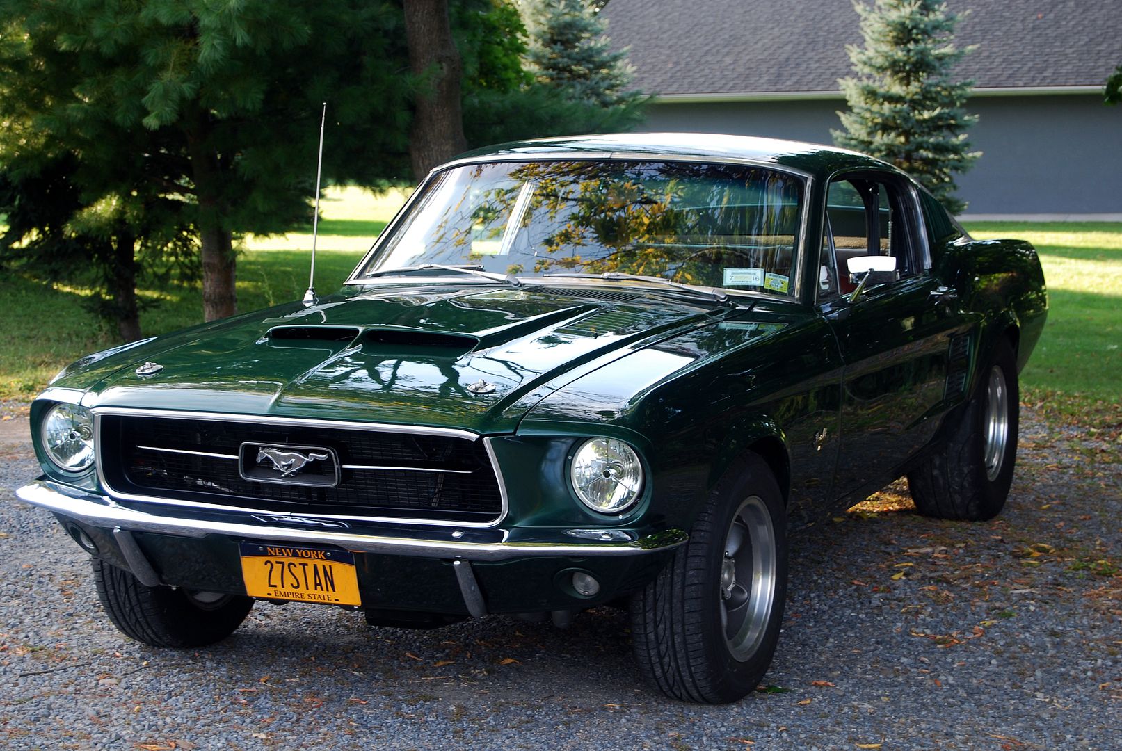

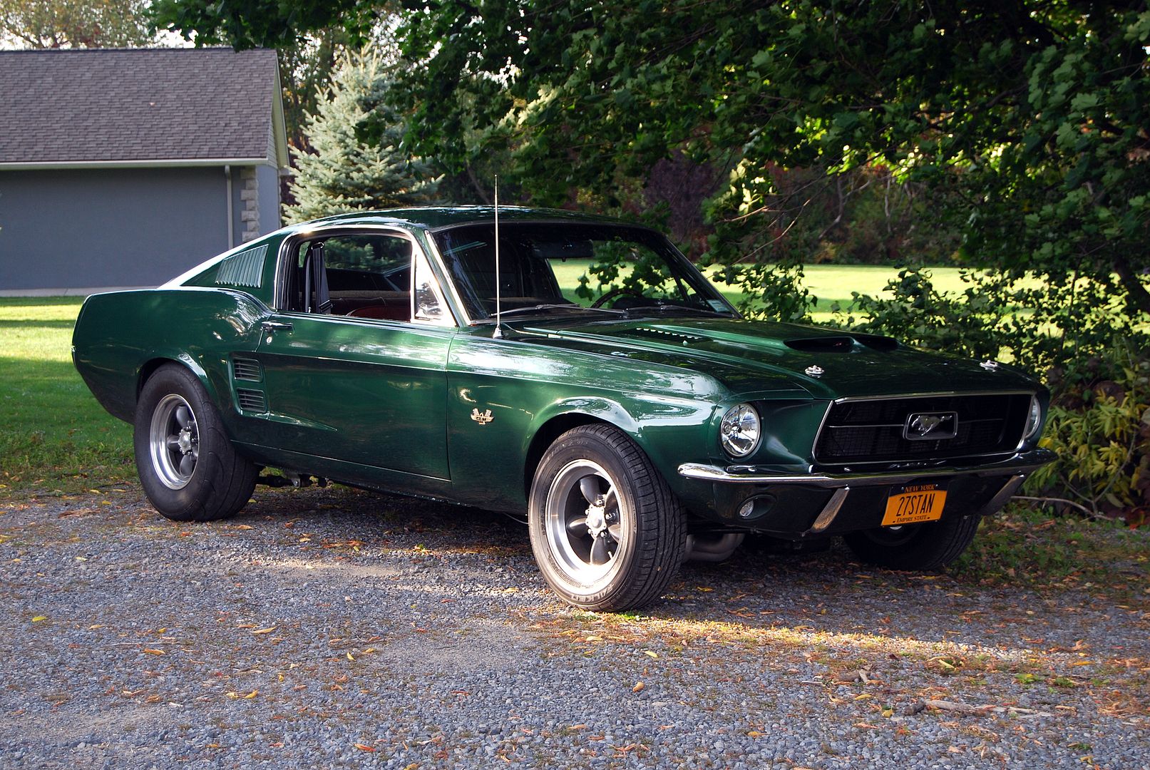

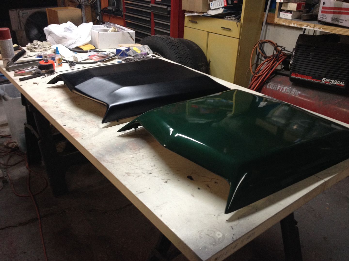

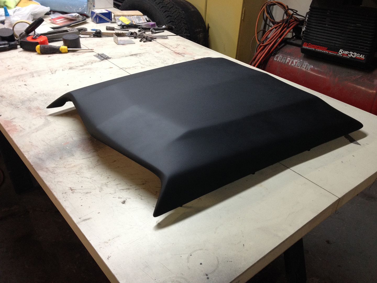

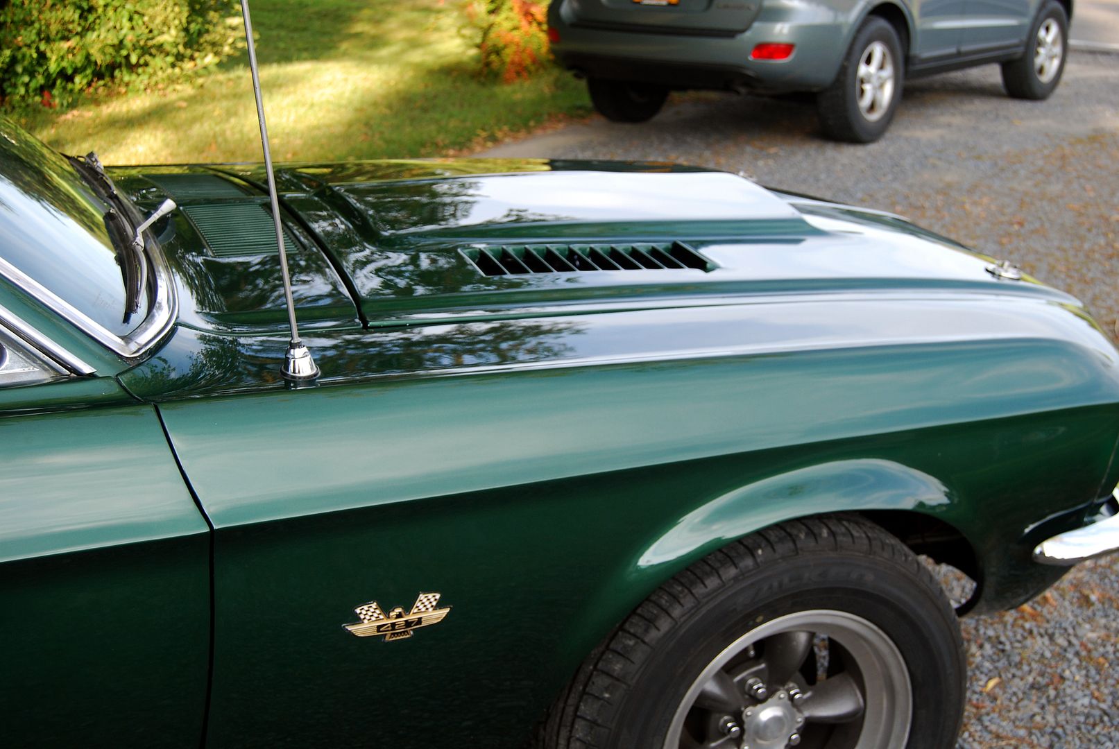

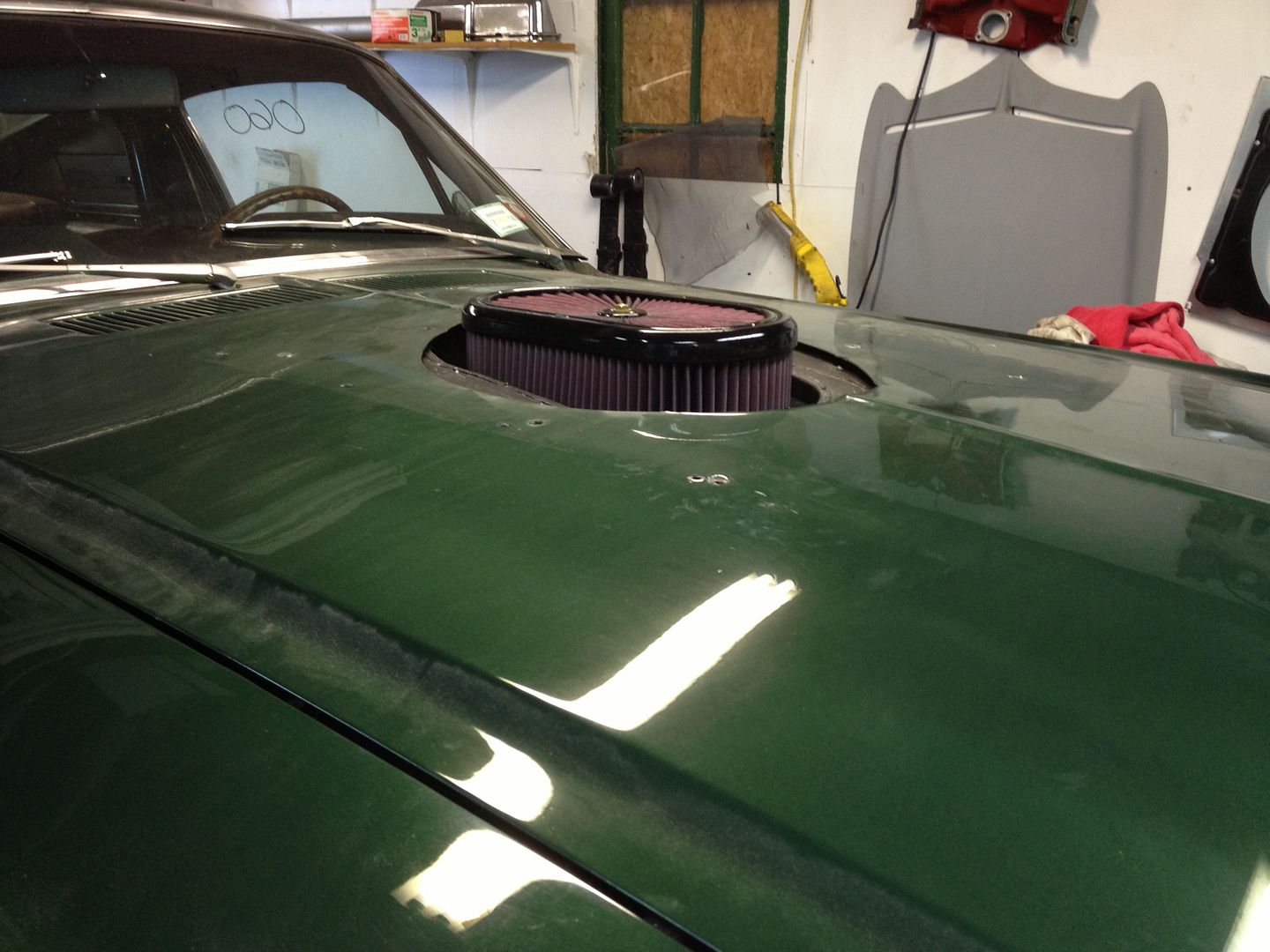

Just a quick update on the mustang. Last year I added a 1 inch spacer under my carb so I made a new hood scope to accommodate it. I never did like it so I tried to design a new one. My intention was to make a 3 1/2 hood scope look like a 2 1/2 scope. After I put it on the car I realized that I did not like it either. I started thinking that ford might have a better idea and so I bought a new hood with the scope on it. Here are the pictures of the two hood scopes that I made and then the new hood.
