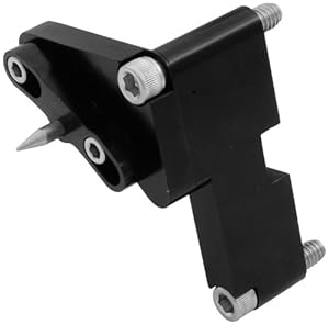

Between this cover and Jay's cover we now have some great options. I'd love to see someone make an adjustable timing pointer that has the same high quality. Maybe something like this....

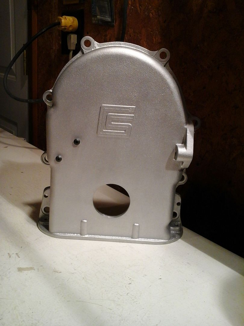

Here is the timing cover I was planning on using for my next build. Nice piece, but there are a couple things I don't like.

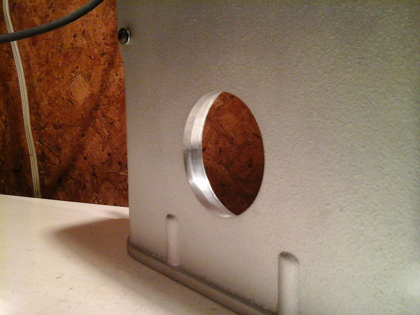

Just a rear installed seal

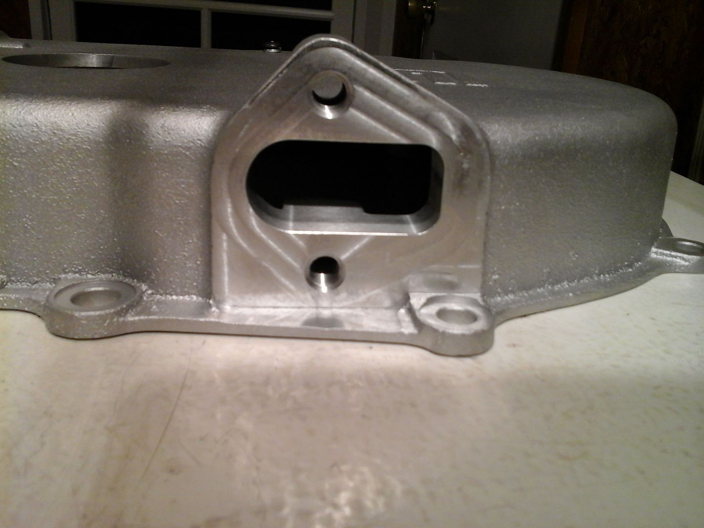

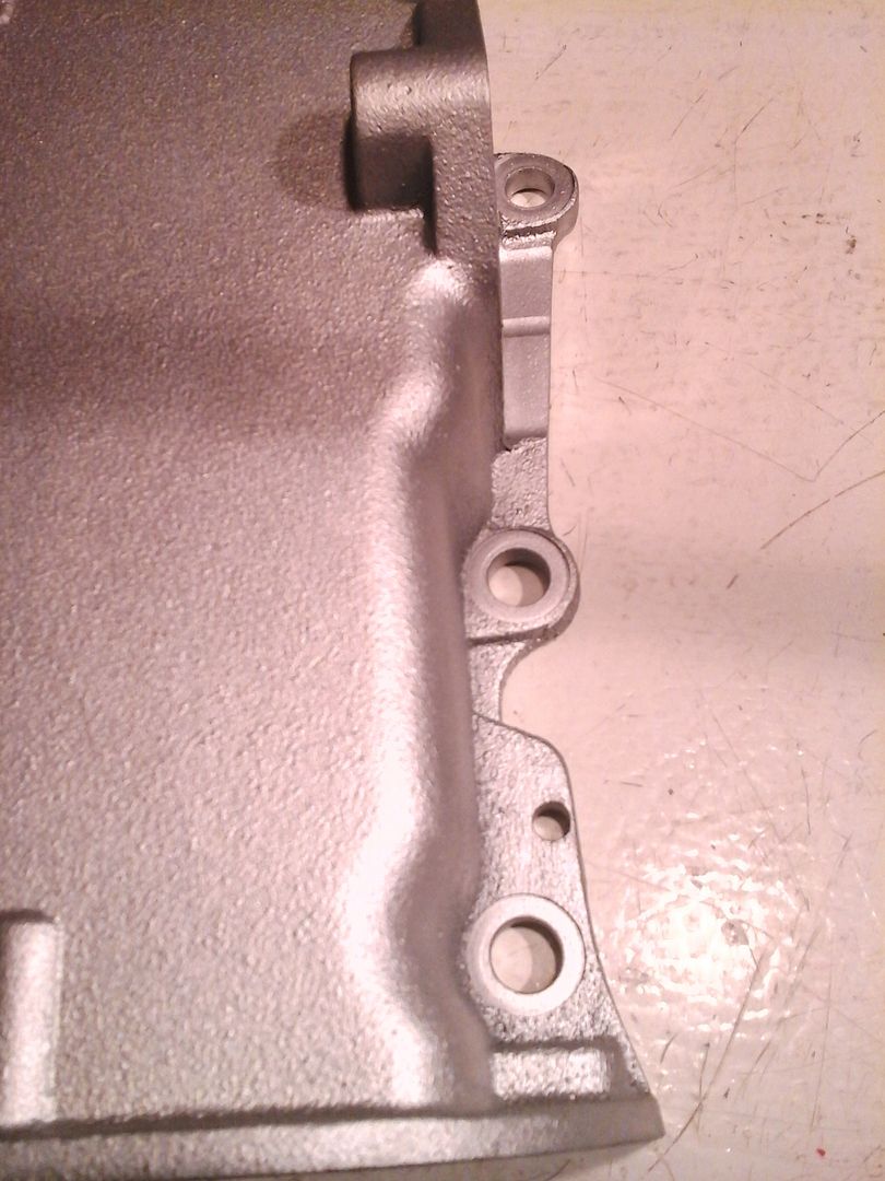

Here is the fuel pump mount

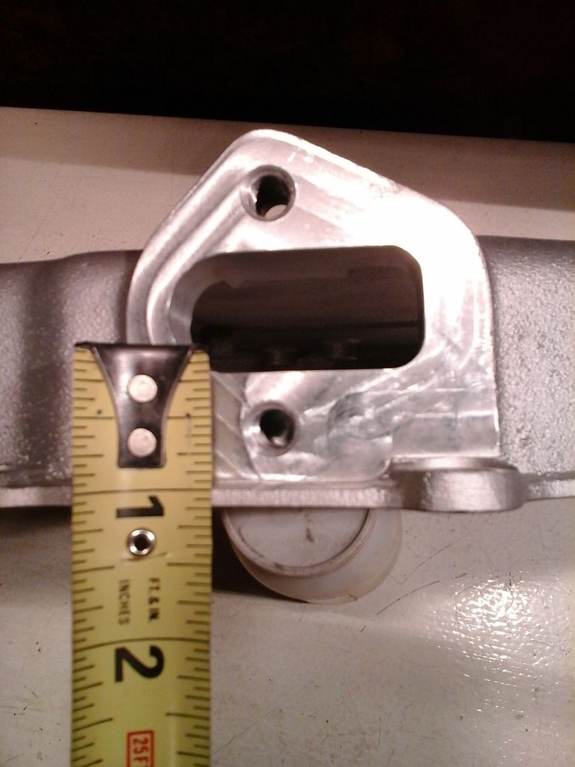

Cover flange is only 1/8" thick 3/4 of the way around the cover :-\

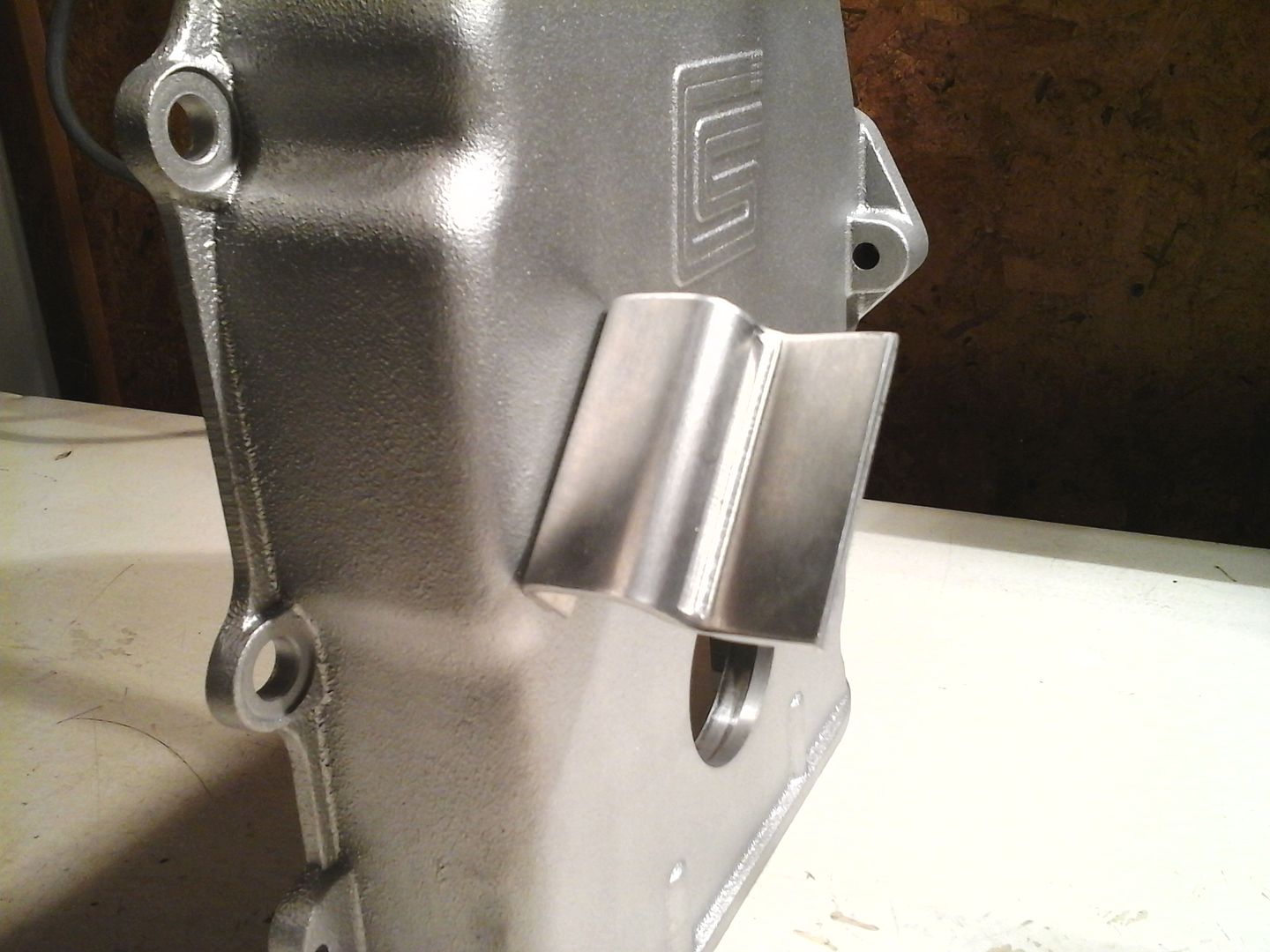

The inside

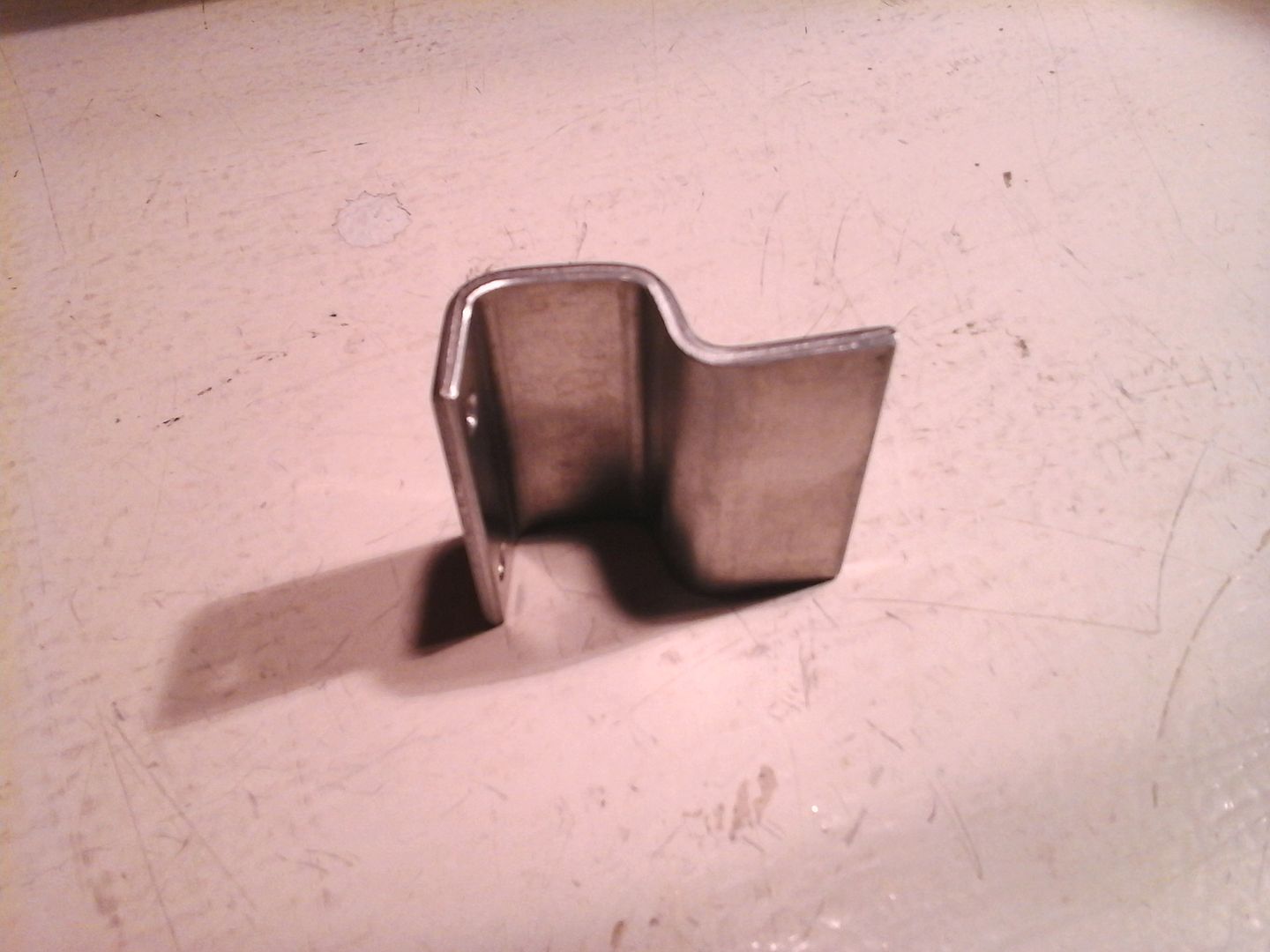

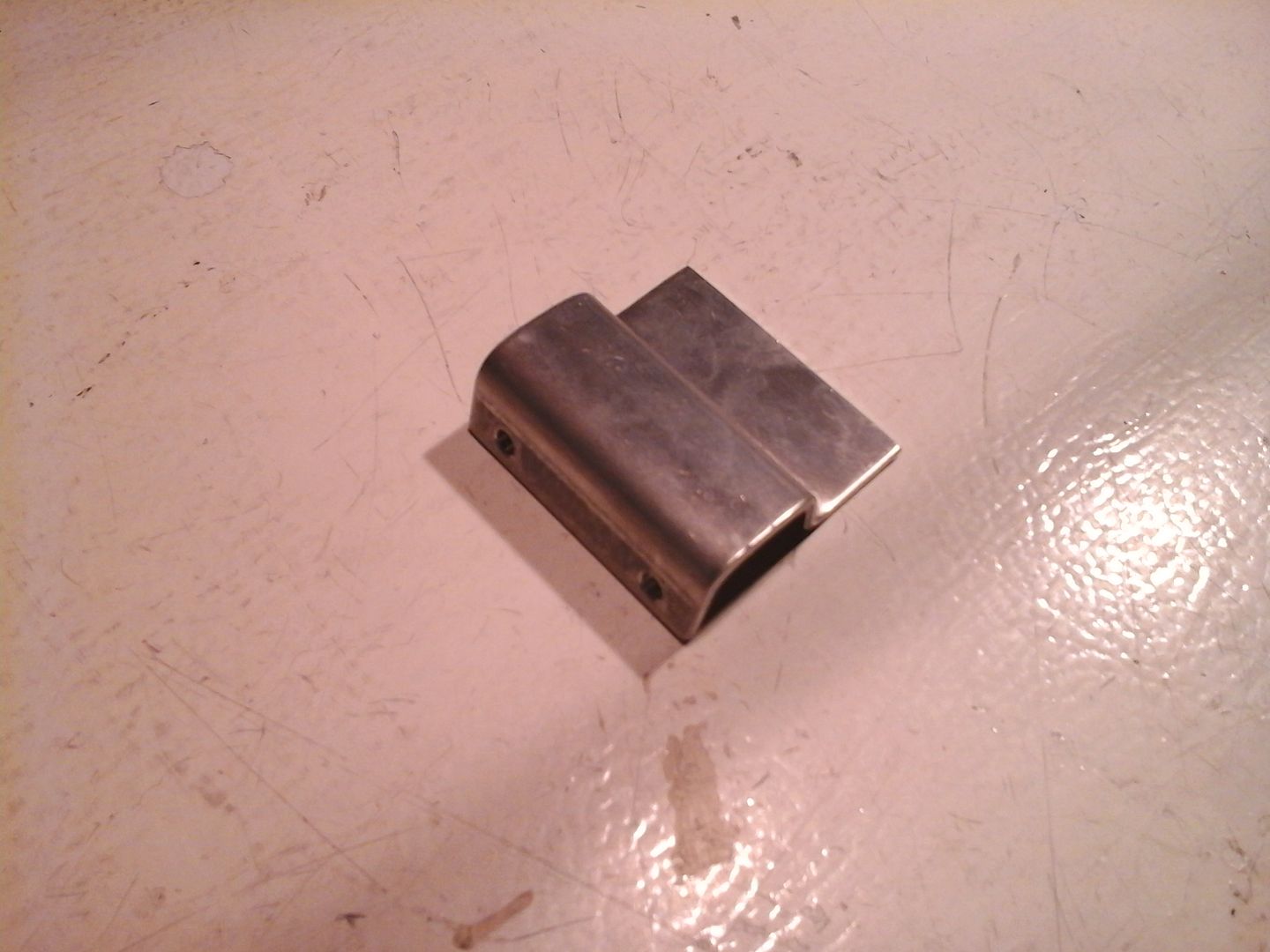

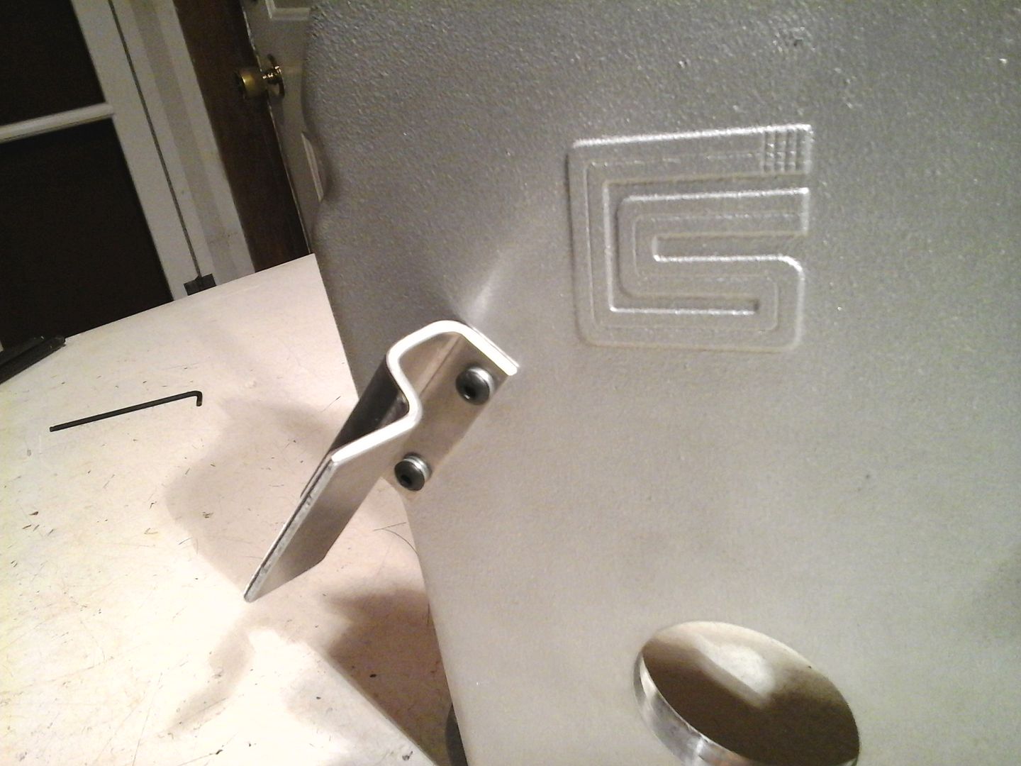

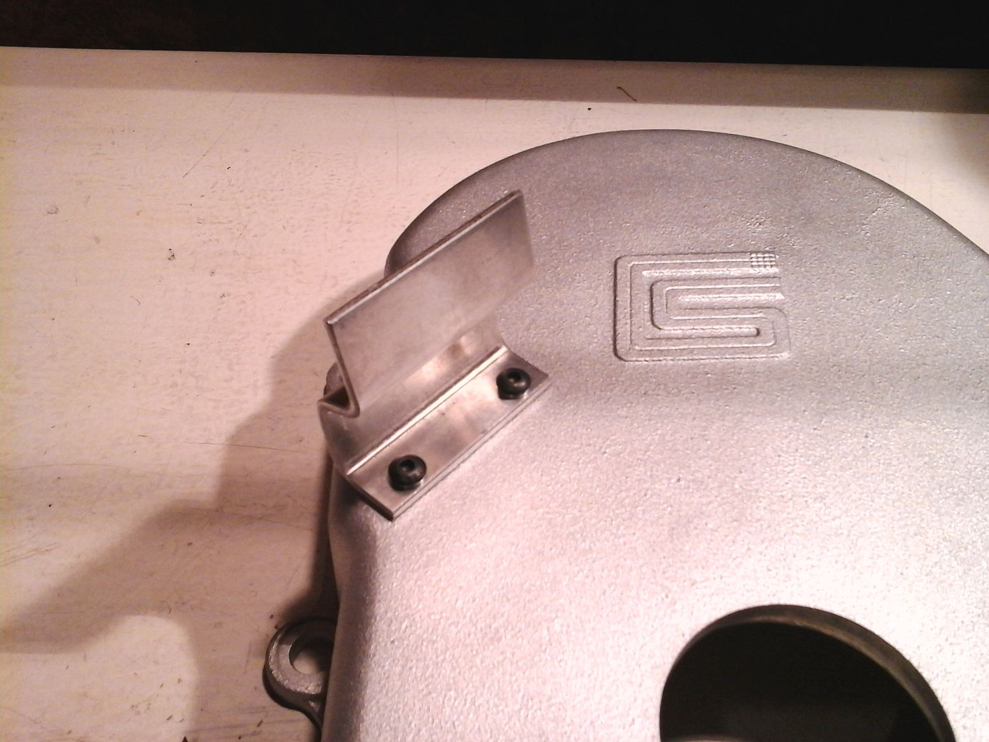

Probably the cheapest timing pointer they could think of. ::)
I do like the extra hole on each side for alignment dowels
