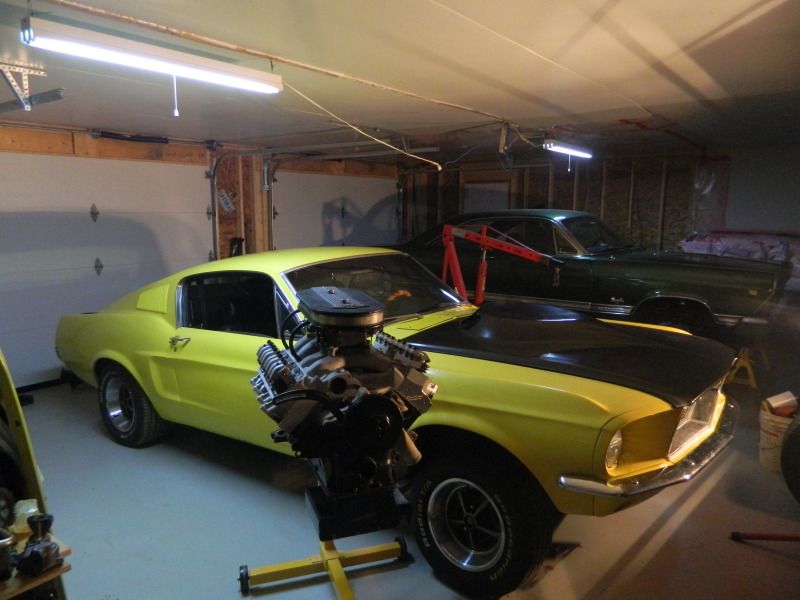

Well I'm not in the same zone as Blair for building FE's, but I'm pretty confident that my 428 is working pretty good.
I actually have pretty much the same 482 that Blair sold, mine is based on a Genesis block,
but pretty much the same, Tunnel Wedge and BBM and such.
Someday I will actually assemble it. ::)
I'm sure he has the bearing clearances just right so it must be boosted at the pump.
My 482.
