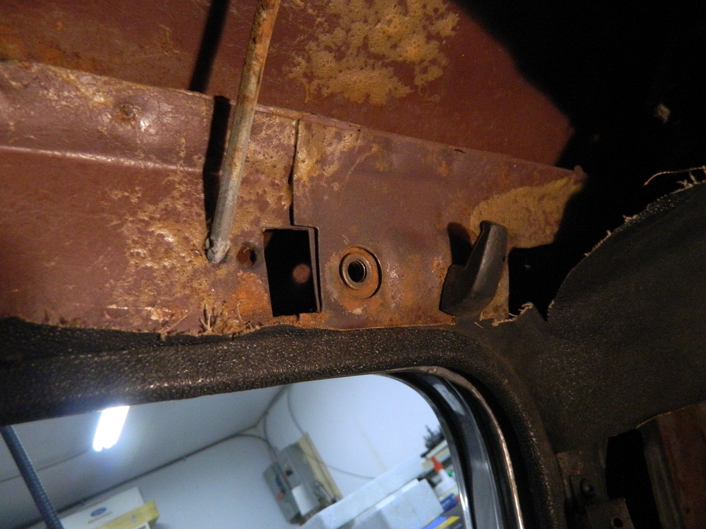

location and hopefully the some way I can get an idea on the reinforcing. I'm adamant about having a properly secured upper shoulder harness in the proper location installed.  Lost a friend in high-school that died by the steel javelin. Have a 67 Tilt column and want to retain it.
 I'm looking for a picture or group of pic's showing the location even an idea how FoMoCo did the backing etc. would be off the charts helpful. Mine's a fastback and presume it makes a difference.
 Hopefully someone has a shoulder-harness 67-68 Fastback that's lacking a headliner they can provide a few pics of.

I believe Shoulder Belts were optional in 1968. They were not optional in 1967. (there's no place for factory to install them in body) 68s have the ability (location die stamped in sheetmetal and maybe maybe-not the female rectangular reinforcement plate) to factory install the optional belts.

The shoulder harness was an option in 1967, check the last page of this link:
https://media.ford.com/content/dam/fordmedia/North%20America/US/2013/11/18/1967_Mustang_Specs.pdf
The shoulder harness became standard in all Fords in 1968, per government safety standards. Ford knew this was coming when the '67-'68 Mustangs were being designed. The second picture Falcon67 posted shows the circled threaded insert for the shoulder harness. I believe all '67-'68 Mustang / Cougars ( except convertibles ) will have that threaded insert under the headliner.
The '67-'68 Shelby fastback rollbar has a tab there and bolts to the roof at that threaded insert. Jay's '68 Shelby is a convertible so it uses a different style rollbar.

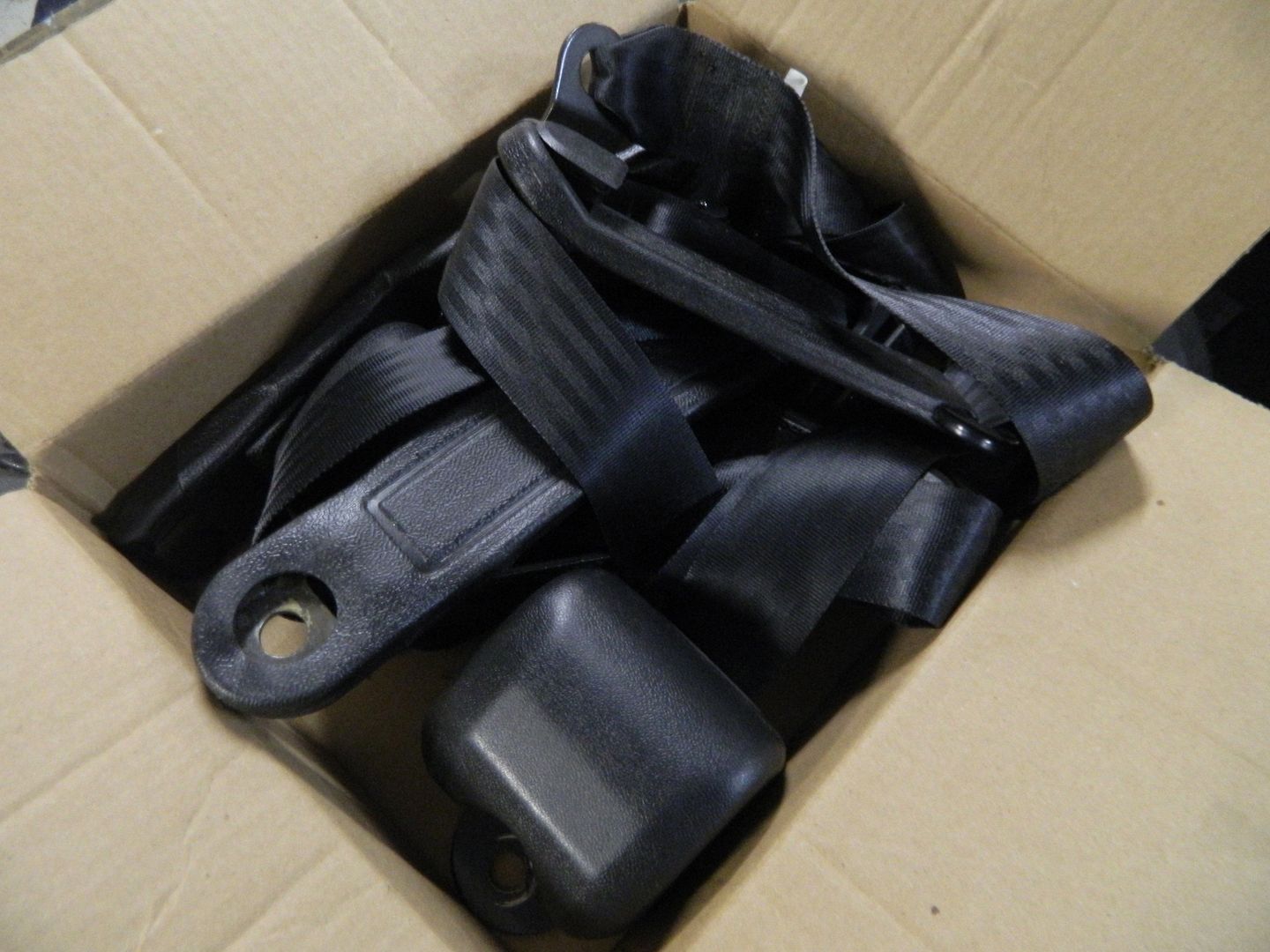

More work involved.  :P
I went out to the shed and got the picture of a 68 Fastback mounting hole.
This is my POS and I've own this car for a long time and when I first got it
still had the upper shoulder belts.
I installed 3 points in it about 2000 maybe? A while ago anyways.
It is a Canadian Fastback. Meaning sold new in Canada.
It is a standard black interior car.
The box of 3 points also.
I like the 3 points. The more you can do to stay in the seat the better your chance of
getting in another seat. jmho
