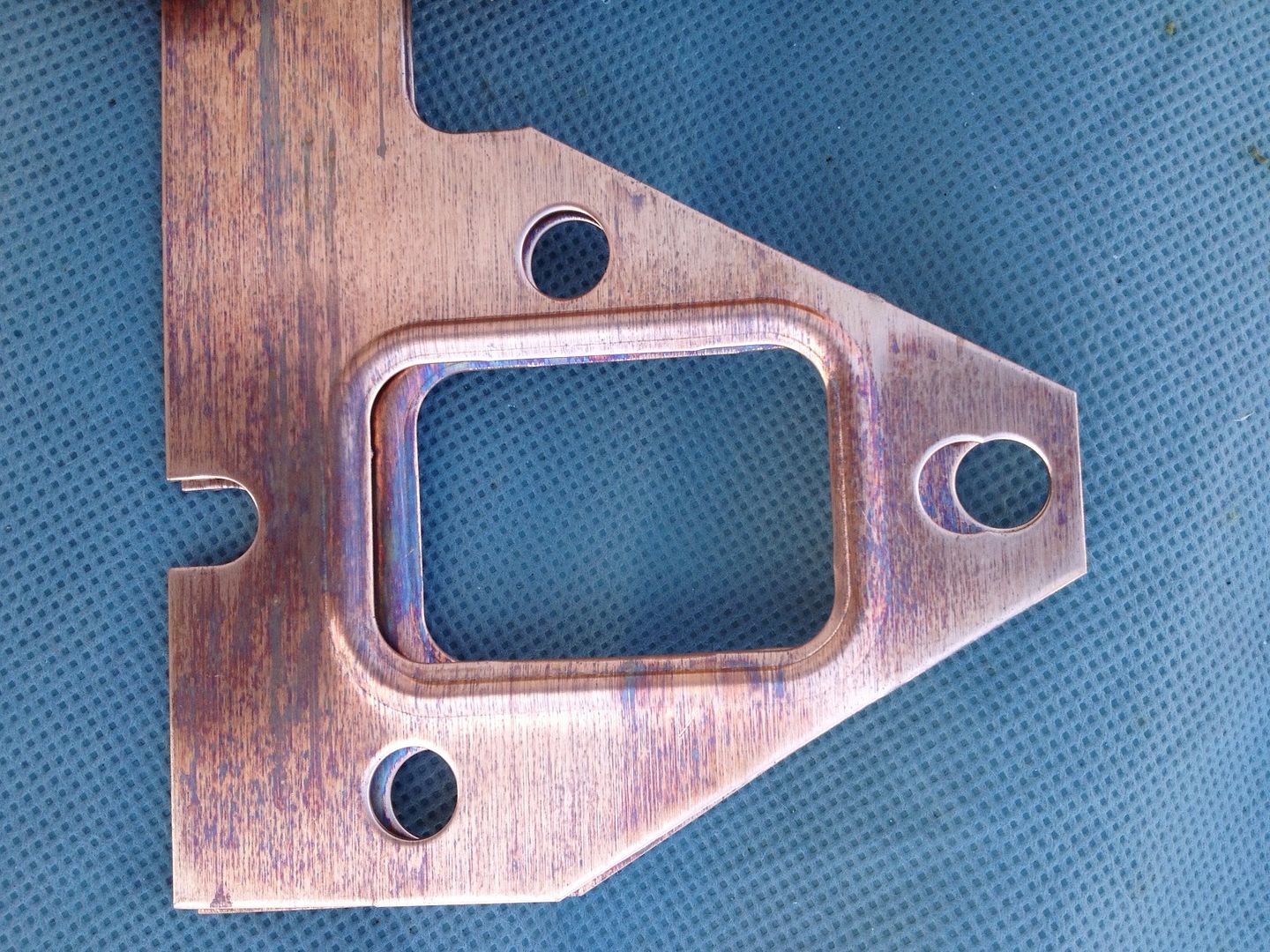

« Reply #24 on: November 25, 2015, 03:42:41 PM »
Port Locations.
The exhaust port on a later head is about 1/4" lower than the early head exhaust port.
Some pics to give you an idea of what it looks like.
Re: Head choices
« Reply #25 on: November 25, 2015, 04:03:21 PM »
Here's what it looks like overlapped.
With gaskets from the right company ;) SCE.  ;)
Re: Head choices
« Reply #26 on: November 25, 2015, 04:10:21 PM »
I prefer the flat coppers to the embossed ones.
Do they make flat ones?
