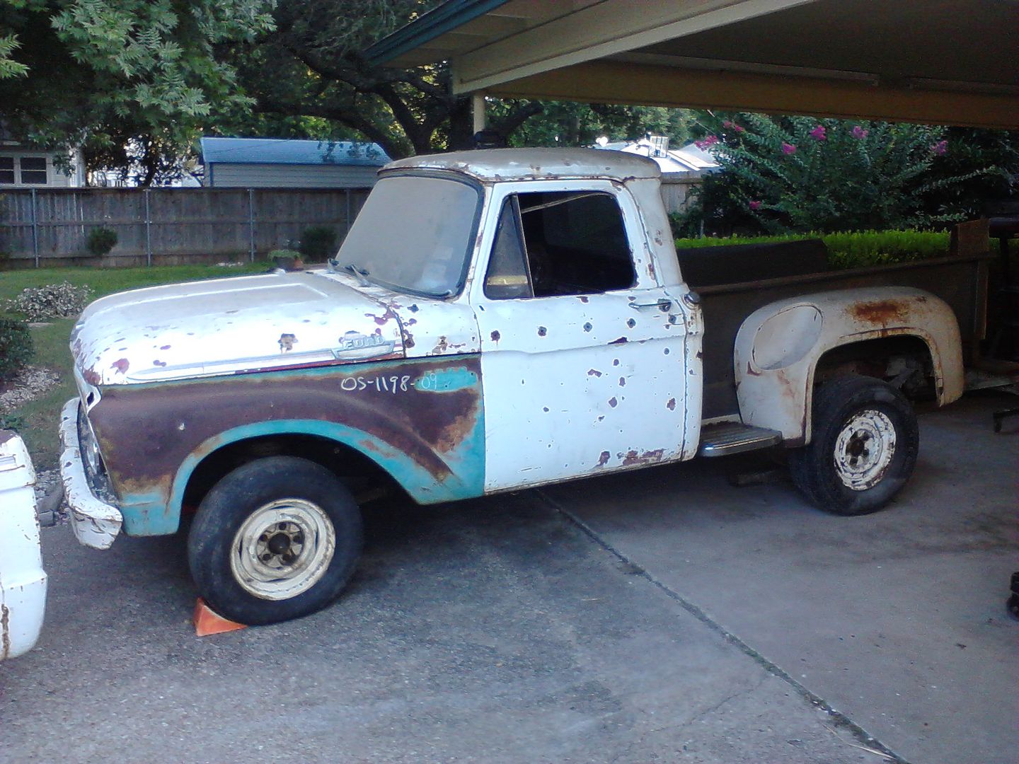

I love 65 and 66 Ford pickups.  Got any pictures of yours?
