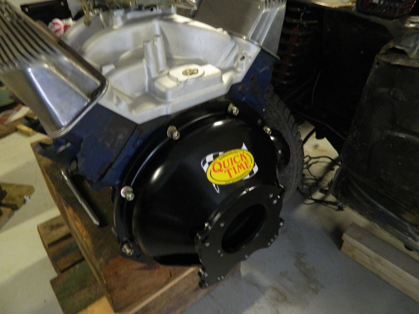

Sure looks sharp, details? :D  What's the destination vehicle?
Early 1968 390 Block @ .040 (good sonic check)
9.9 to 1 comp
Piston to deck clearance is +.002 (was shooting for .000)
Decks squared, final hone w plates etc
1U Crank
BBM Heads (flow numbers in another post)
Pretty much as in pics the obvious Perf RPM intake
Quick Fuel HR 780 carb (do not like the shiny finish but they would not do in black
1 3/4" Truck Headers
Special Grind flat tappet hydraulic cam, stock rockers
No "tricks" just careful assy
It would be nice to send up to Jay B for a dyno session . . . That way the numbers will be accurate. Not much for dyno here that I trust.
