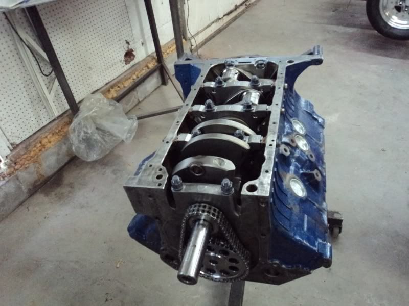

PIcked my block up at the machine shop last weekend, after some issues last year I get another place to clean it and put cam bearings in.
I stuck the sleeves into the crankcase abot 3/16 to 1/4 inch assuming since people were putting big stroke cranks in there was lost of room. NOT!!!!!!!!!
A ton of grinding and everything now rotates like it should. PIcked up the clean block last night and started assembly today.

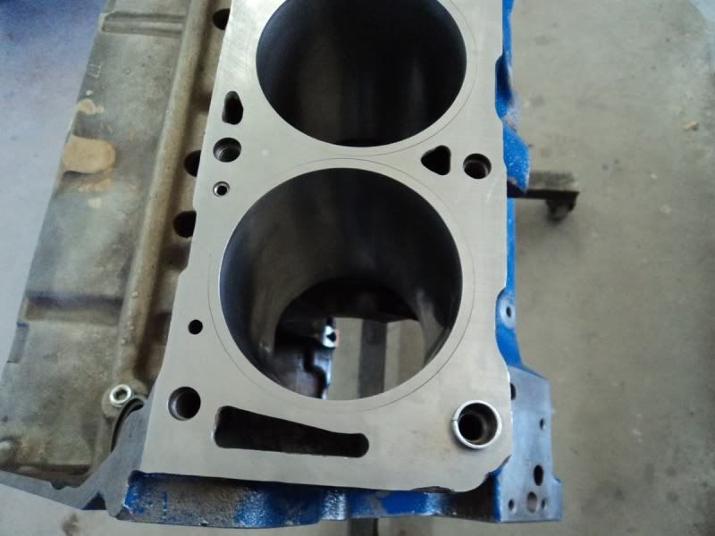

Pic of the deck

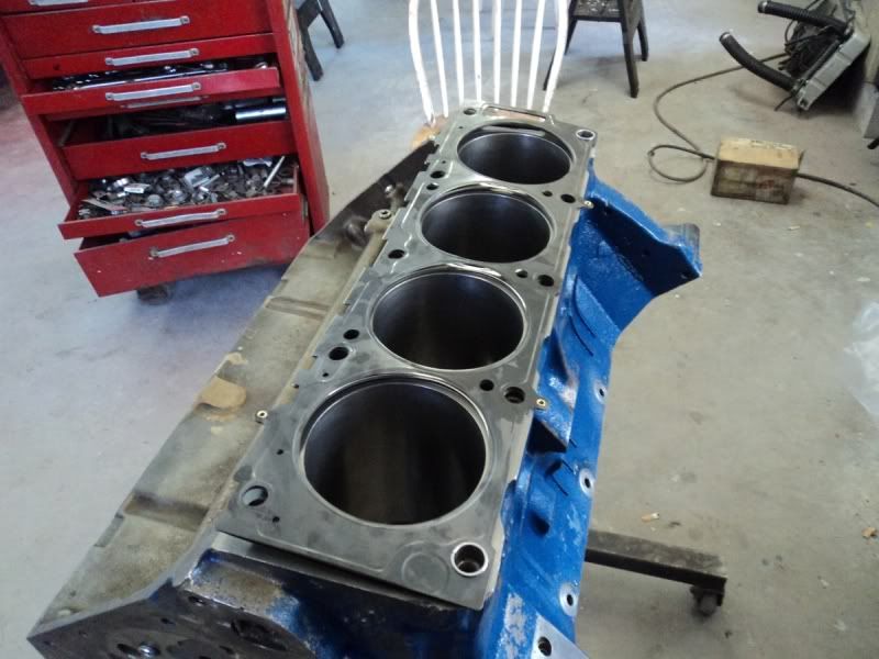

On another note I ordered a cometic gasket kit for my motor, I wanted the 4.3 bore gasket so the gasket would sit on the top of the sleeve but the ridge is awful close to the edge of the sleeve so we will ahve to see how it works out. But interesting gaskets, it was what they call a Street-Pro top end set, can be bought for about the price of 2 of their regular head gaskets and the gaskets look the same to me.
But this is the first time I have seen MLS gaskets and they were quite a surprise.
Top view of head gasket
All metal is interesting but the end view of the 3 pcs flopping around threw me for a loop
