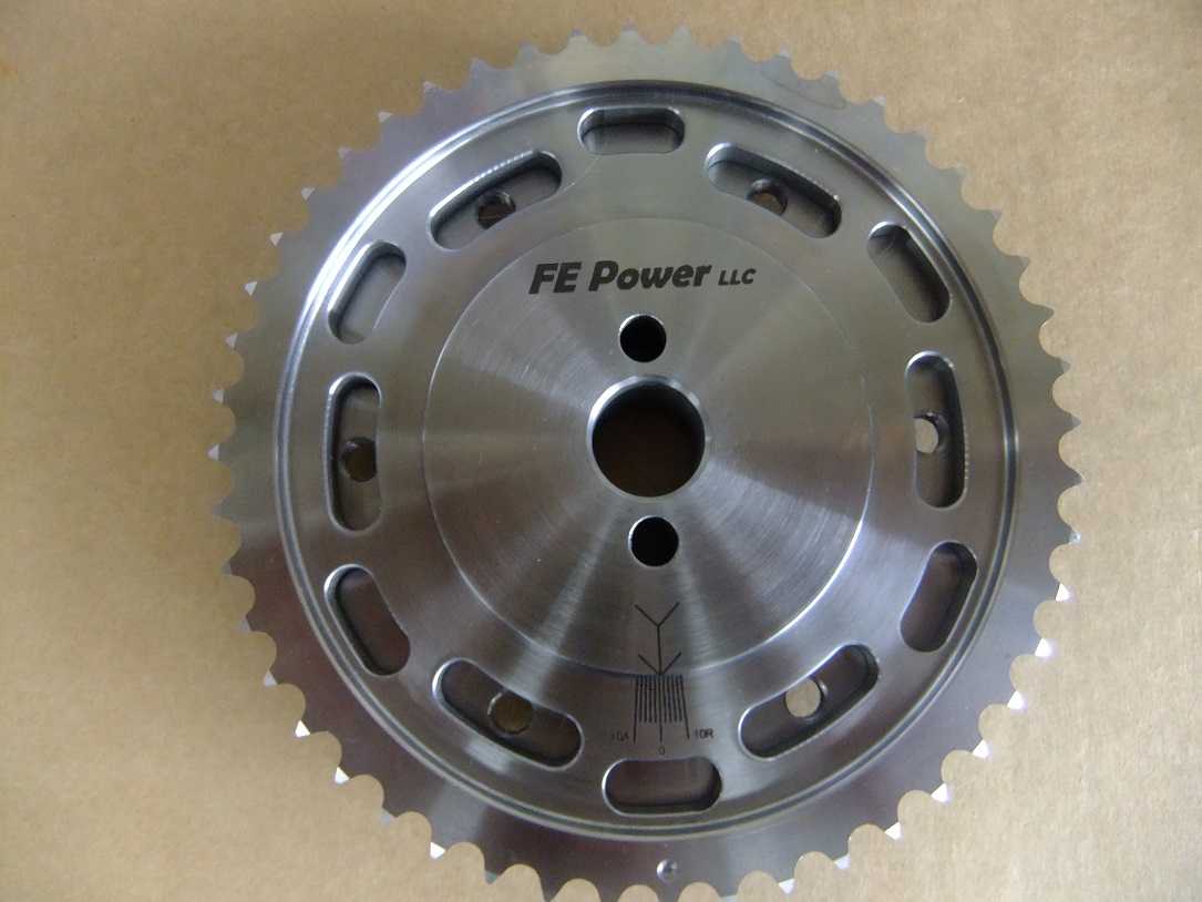

My new timing gears FINALLY shipped from Australia on Friday.  I should have them in about a week and a half; I will post when they are available.  Here is a picture of one of the top gears:
I agree with Barry that the slotted arrangement shouldn't be a problem.  There are six fine threaded bolts holding the two parts of the top gear together, and torquing them to a reasonable value should keep them locked securely together.  You could pin them if you wanted, but that kind of takes away from the advantage of being able to time the engine while it is put together.
Thanks Jay and Barry! One very cool piece.

I was concerned about the mechanical fuel pump arm; the height of the nut and washer over the gear can interfere with that arm, leading to problems if you want to run a mechanical fuel pump.  I ended up going with button head cap screws, which clear the arm with no trouble and of course would be installed with Loctite and torqued.  Besides, they are cheaper than the studs, nuts, and washers, and the cost of these timing sets was starting to get too high.  I figure that if someone wants to replace the capscrews with some studs and nuts, no reason they can't do that.
