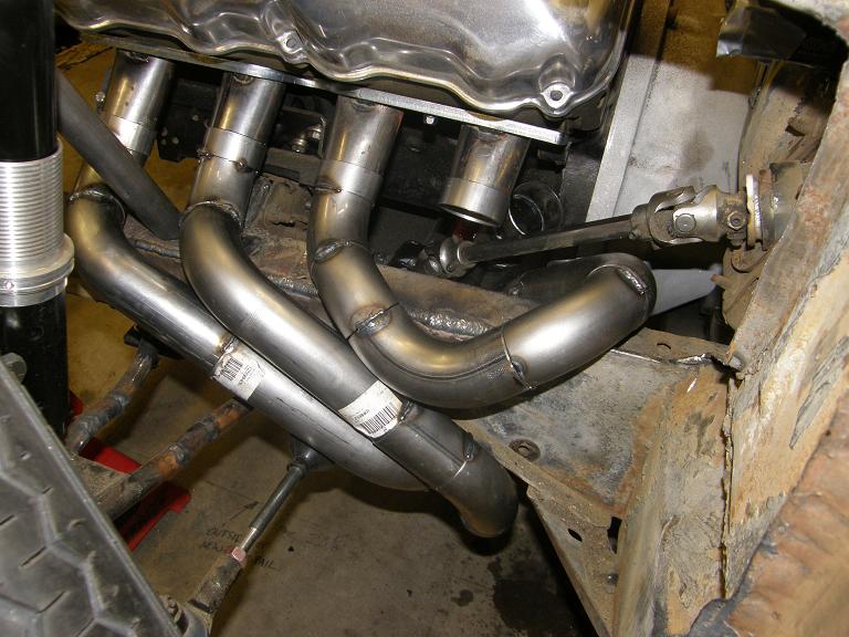

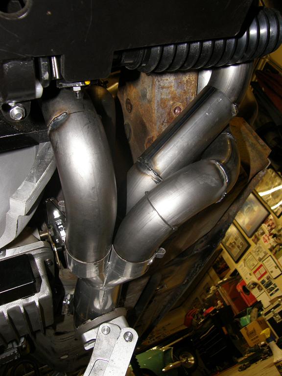

Sunday I finally got back to working on the car.  I started with the driver's side header, and had a bunch of mandrel bent J-bends on hand to make the pipes.  I'm using a stepped header design with 2 1/8" to 2 1/4" to 2 3/8" pipes, plus a slip on collector.  I stared at the car for a while to try to visualize where everything was going to go, and then started on the first pipe.  I've probably built 15 sets of headers in my life, and after coming up with a basic strategy for each side I've found that the best thing to do is dive in and start cutting and fitting.
Cutting to the chase, eight hours later I had the driver's side done, with the exception of the 2 1/8" pipe from cylinder #8 to the 2 1/4" pipe coming up from the collector.  I could have done that one, but I was trying to maintain equal length and this tube would have been a good 6" longer than the rest if I'd built it with the pipes on hand.  I figured out that if I bought some of those exhaust pipe donuts from the Chassis shop I could cut at least 5" out of the first 2 1/8" pipe, bringing it into line with the rest of the pipes for length.  So, I've left that pipe for now, and will order the donuts tomorrow.
Here's a couple of photos of the left side header; you can see the missing primary on #8, and in the background the 2 1/4" pipe that it needs to meet up to coming up from the collector, in the first picture:

Having built a few sets of headers my self I can visualize the path you plan to take or #8.
My thoughts whether you like them of not LOL, I personally would not do it, the donuts while they look like an answer have far too tight a radius to be usuable for headers. You would be better off with unequal length than the very tight radius for more than 150 degrees to get to that tube.
Larry Meaux of pipemax fame has done the testing and equal length does not make enough difference. Our local Super Stock guru found the same. His cobbled up rush to fit headers made the same power as a set of ultra hi dollar ones he borrowed to test. The hi dollar headers were built for one of his engines. After the beautiful work you have done to now the very small radius will be a dissservice to the rest of the header.

Thanks for the comments, Mario.  So, you are saying that by using the very tight radius of the donut bends that this will restrict the exhaust, and have a more negative effect on the power output than one extra long primary tube?  I guess I hadn't really thought of that as an issue; radius of the donut tube bend is about 1 1/2", and radius of the normal J-bends I'm using is 3", and I figured as long as the pipe was smooth I'd be OK either way.  Where would I find more information on this?
By the way, I use Pipemax when calculating lengths for headers and intake manifolds, but based on the dyno testing using my Hilborn setup it doesn't translate perfectly in the real world.  Pipemax predicted a 17" runner length would be optimal for my Hilborn setup on the big SOHC at 7000 RPM, and 20" turned out to be what the engine wanted.  It also gives conflicting results on exhaust system lengths; for example, on this set of headers, Pipemax says that the OD of the first primary tube should be 2.275", but that for optimum exhaust gas flow the pipe should be 2.1".   So, my opinion of Pipemax is that its a good tool that will get you in the ballpark, but it is no substitute for empirical testing.  You probably knew that  :D
