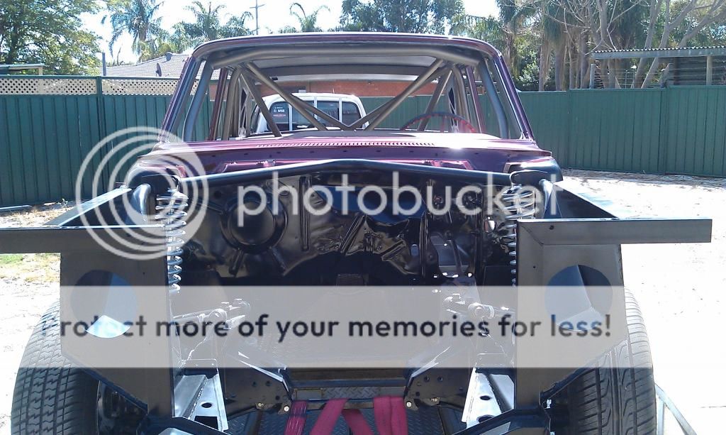

The front suspension uses the original lower control arms, strut rods, spindles and frame mounting points. The modified parts are tubular upper control arms that have the same dimensions as the original upper arms, use the original ball joint and mount to the frame at the original points. The springs and shocks have been replaced with coil overs that attach to the upper control arms and the forward section of the roll bars that run forward through the firewall and down to the front section of the frame rails.

I like how you did the front end !! ...... the way shock towers should be !!

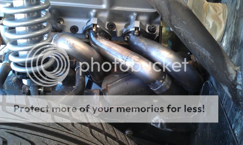

Todd are your headers custom built? And are you running stick or auto? Got a shot of the left side linkage and header area if its a stick car?

The car was originally set up to use a stick shift, but the fabricator I used thought I should use a hydraulic clutch set up. I have a Jerico DR4-4 to use in the car, but I can not find a hydraulic throw out bearing to fit on the input shaft. I could try and use a slave cylinder to activate the clutch lever, but haven't gone that far yet. I could also try and make a custom linkage, but it's pretty tight in there with the mid plate, even though I'm using rack and pinion streeting.
The car currently uses a C4 built by Dynamic Racing. It will help me to get the car sorted by not having to worry about clutch adjustment while I'm getting everything else sorted. I have it set up with a delay box, as they are legal in the class I race in and help me be competitive. I would like to eventually go back to using the Jerico, as I think it would better suit the nature of the car.
Below is a picture of the LH side headers before I changed the steering set up. This is probably part of the reason the car has taken me so long to build, I keep changing my mind about things.
