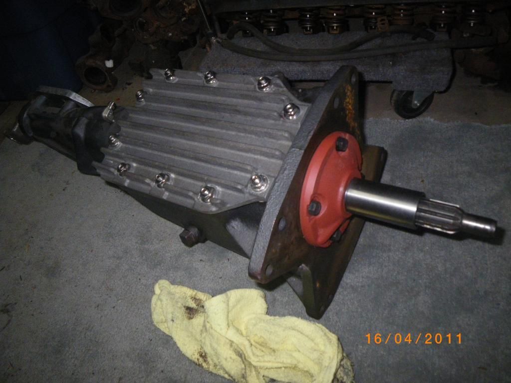

No idea who made the finned cover..

The aluminum toploader cover is a Jerico part.  I'm not sure if they still make that cover.

Interesting about the Fairlane springs..I will have to look at that..The cover does look like a Jerico but I cant confirm it.

Pictures of Jerico top cover and a stock steel top cover.

Certainly looks like it....I bought it off e-bay.Seller claimed it was magnesium but it was not...I didn't pay much for it..I always plug the vent hole in the lid and relocate it to the tailshaft so it worked out fine..
