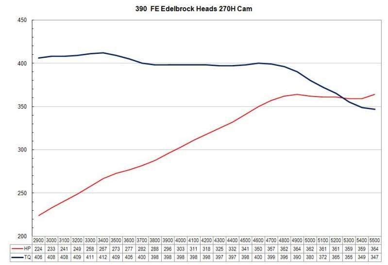

1 - The small ports / long stroke (compared to a 351C) will be a completely different animal.  In addition, the intake port length is long, and the 1 3/4 primaries all contribute to torque.
2 - I was harsh with the 270H being a truck cam, but it is a relatively mild cam.    FWIW Barry did a dyno of one pretty close here, keep in mind it is well under 400 hp and peaks real low.
http://fefordtech.com/index.php?topic=40.0
It's a nice motor, but really for a 3.25 or 3.50 gear car, it starts to flatten out around 4900, and that is exactly what I saw on my 396 inch truck motor.
