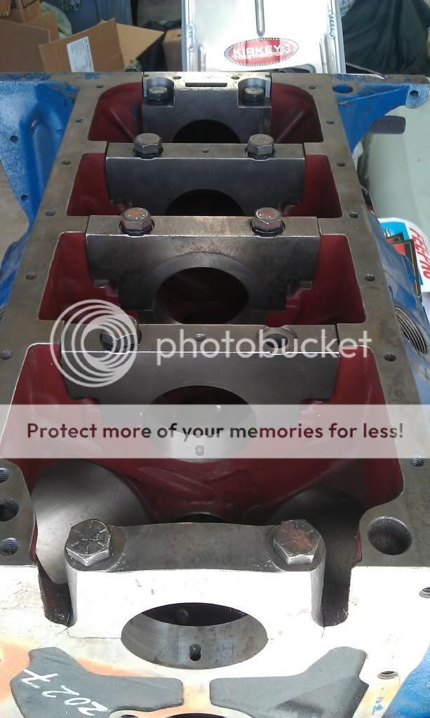

Hopefully a pic of mine.

I just got home from work and checked my block - apparently it is a later production block with the bigger nodular iron main caps. Phew!

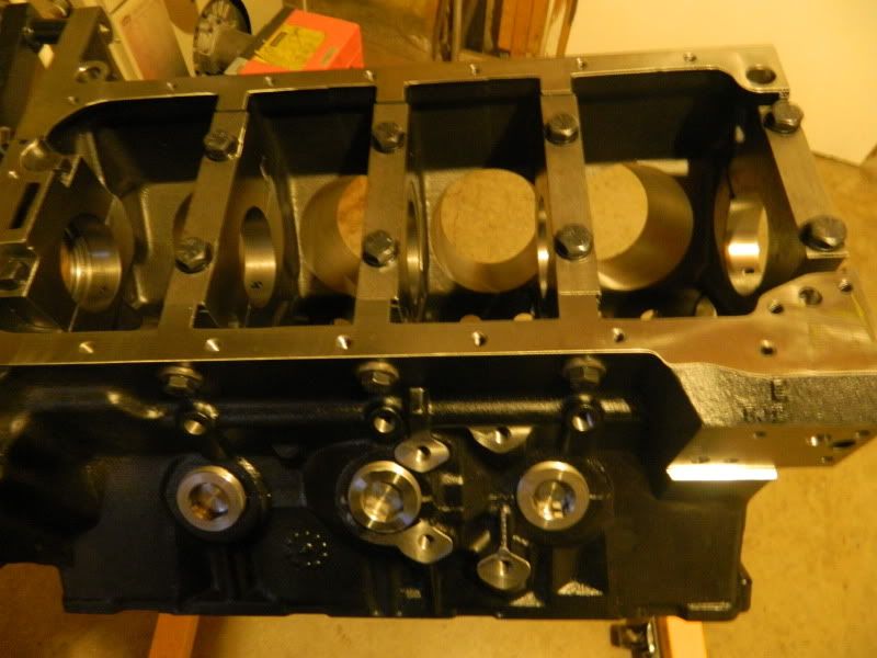

A pic of my Caps.
« Reply #27 on: November 11, 2011, 02:12:56 PM »
My block was drop shipped to me through Barry this year.
It will of course need a full mock-up and inspection and most likely a bit of touch up.
I would say I'm more than happy with the size of my caps.
Can't say the same about my wallet though. LOL
Whether they are Nodular or Gray cast I can't say.

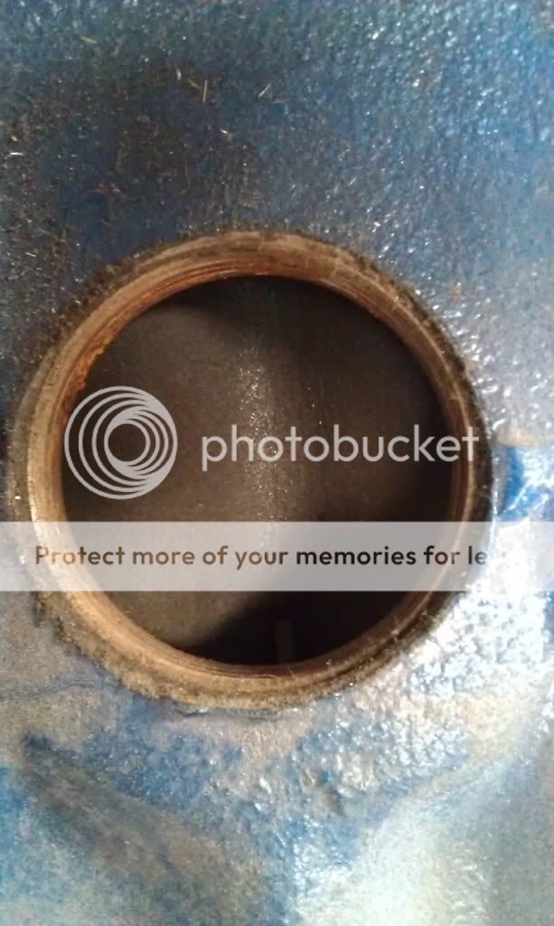

Todd or Howie could one of you please post a pic of inside the screw in freeze plug area inside the block? I have never seen the siamese cyl walls inside. And my block came with the plugs installed and sealed. No joy here. Thanks.

« Reply #29 on: November 12, 2011, 03:36:43 AM »
No problems, as my block came without the screw in plugs. Hope this pic is clear enough.
