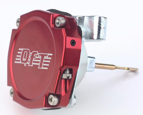

I"m looking and Quick Fuel has two products that I find interesting.
63-1QFT Quick Set Adj. Sec. Housing - makes the vacuum secondaries easily adjustable.

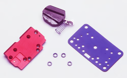

And  the 34-2QFT Billet Metering Plate Kit - Saw a video with Steve Brule and Richard Holdener https://www.youtube.com/watch?v=0IwoNX0PGEI

If you don’t already have updated plates in secondaries, ( the type where you can swap jets out), then yes, get that kit or something equivalent.
The tunable vac pods are an upgrade but guys just changed springs forever and got it done. JMHO

I have used the QFT metering plate kit with good results. Just be sure that the jets don't slightly touch the float as it will on rare occasions. Once installed turn the carb upside down and you should be able to hear if the float moves freely in the float bowl. If you're cheap like me you can drill and tap the Holley metering plate with I believe 8-32 brass set screw and drill them for whatever jet size you need.
I have used the Holley quick change secondary spring kit with good results as well. Much cheaper than the QFT pods. There is a boss in the cover that you can drill to install a tube into so you can retain your balance hose between the carburetors.

I too have used the QFT billet secondary plates successfully, but one thing I had to do was fiddle with the idle fuel feed orifice sizing. On my application, the idle fuel feed orifice diameter was way too big, and made the idle circuit way too rich. I couldn't get it to run decently at anything other than WOT. Looking at the specs for the plates I was replacing (which I got from an old Holley book I have) and comparing them with the specs for the QFT plates, the idle feed sizing was way off.
The QFT plates have a screw in idle fuel feed that's basically a tiny worm screw with an even tinier hole drilled in it. I called QFT asking for either worm screws with different orifice sizes or blank worm screws, they didn't have any, so I sourced some from a RC Car supply company of all places. Then I found the appropriately sized drill bit (from Grainger) to match the orifice sizing in the original plates, and drilled the feeds in the replacement worm screws. Solved my idle and part throttle issues just like that.

They do make a bunch of different plate sizes, idle feeds and main feed sizes if you know what you need , keep fuel under 5 psi fuel pressure for side pivot bowls . I do like the vacuum secondary unit but have only used them on single four barrel carburetor applications and it is a quick easy adjustment
