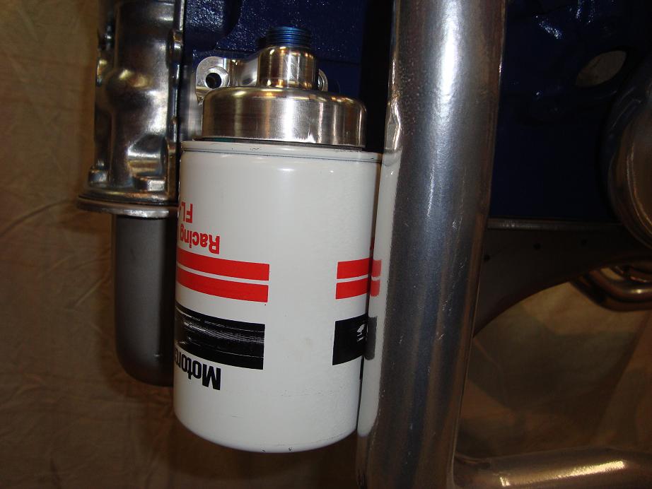

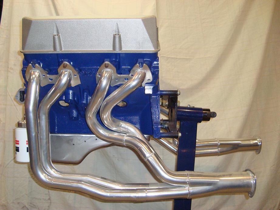

Here’s some pictures of the Hooker Super Comp #6113 headers for Fairlane/Torino/Comet. I purposely bought these years ago for my ‘66 Comet because they would fit the factory clutch linkage. I later ran these in my ‘68 Torino. I never tried with the factory power steering, like Doug said most FE headers often require at least the lowering bracket for the hydraulic ram, but personally I always have removed the PS. I post the pictures so you have some stuff you can compare. The oil filter comes very close to the two forward drivers side tubes on these, you might need to use a remote oil filter mount.
Some headers will fit both the Fairlane/Comet chassis and the Mustang/Cougar chassis, some don’t, you just have to check the applications or recommendations closely.
A few years ago I made a post here with various FE header pictures, my hope was that people would continue to add pictures of their headers to help people choose, but unfortunately the post didn’t get much traction, I’ll see later if I can find it.

As for power steering in general, on shock tower cars, I have installed on several of my 70 Mustangs, both with 351 C 4 V, and 428 Cobra Jets, with automatic and 4 speed transmissions, and in each instance, a power steering "drop bracket" was required to clear the PS cylinder. The typical drop bracket, supplied by the header manufacturers present at least 2 common problems, first, the rather flimsy steel construction tends to allow the drop bracket to flex, which reduces the already marginal road feel of that style of power steering, compared to the shorter, and much more rigid cast iron factory cylinder bracket. The can also tear the factory "Riv Nuts" out of the frame rails , that the bracket is mounted to , in the bottom of the frame rails. This can cause the shaft of the cylinder to get bent, as well as making the steering very stiff and sloppy, as the steering cylinder is no longer actually solidly connected to the frame. I have also had the drop bracket, which is made from 2 pieces of steel welded together, break at the weld. In each case, I ended up welding the bracket solidly to the frame rail, and gusseting the 2 sections, to reduce the flexing. It would be nice if somebody offered a much more robust, and stiffer drop bracket . although the Riv Nut mounting situation would still need to be addressed.
Concerning the Hooker 6113 headers for Fairlane/Comets, the 2 front tubes on the drivers side, hang down very low, as they run below the lower control arms, so ground clearance is a very real concern, even at stock ride height. Especially on a street car that encounters speed bumps, dips in the road, or steep on/off ramps. Frankly, for anything other than a race car, I I am a big fan of the FPA headers, although I don`t know how they work with power steering, or the factory clutch linkage on a Comet/Fairlane.

Kevin , are the headers actually touching the filter ? Looks really tight, my 63 Fairlane with Crites has about 1/8th clearance all the way down and yours looks tighter
That’s a Precision Oil Pumps billet filter adapter in that picture, and the Precision Oil Pumps one points straight down, I was able to spin the filter on, but yes it was very close, much less then 1/8”. You could use the smaller diameter oil filter that’s available and gain some more air gap.
The factory oil filter adapter actually tips the filter back a degree or two, the typical FL-1A filter wouldn’t have worked with that. The shorter filter that’s available, or the smaller diameter one might work, but I didn’t try that. When I ran those headers I used a remote filter mount.
I believe John Vermeersch & Barry have mentioned the tip that angle milling the oil filter adapters is another option to gain some filter clearance.
And of course every set of headers can vary a bit, just to add another variable  ;)

The factory oil filter adapter actually tips the filter back a degree or two, the typical FL-1A filter wouldn’t have worked with that. ...
My factory filter adapter with an FL-1 filter worked fine on my '67 Fairlane.  It is about 1/4" clearance.  I later added an Earl's oil cooler adapter and it didn't change that relationship.
