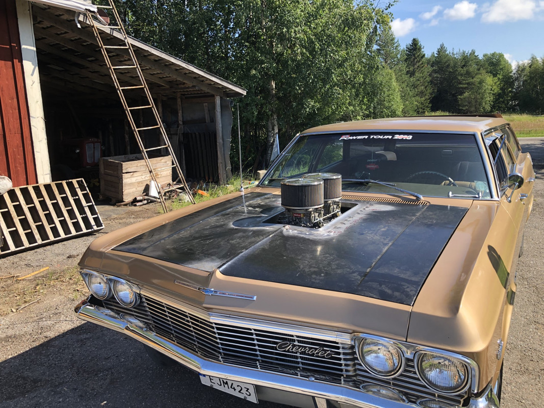

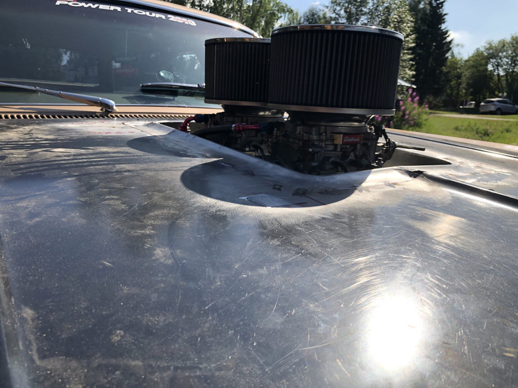

Thanks Doug, 45+years of practise had to give some kind of skills :)
Yes i thought that lip just dont add to the looks but stiffens the hood
and keep some of the rainwater from running down the enginebay

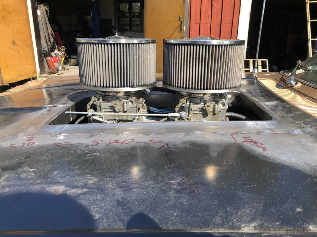

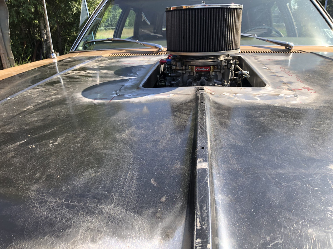

Had some sparetime this morning so i tacked the ridge to the hood
and testfitted it on the car so it cleared the airfilters
Now some hammer and dolly and TIG welding and trim the inside
and build upp the inner structure
