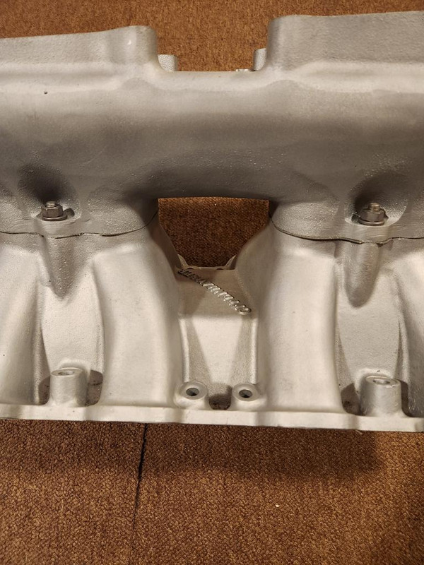

I have an Offy 351C Tunnel Ram Intake, mine uses studs to fasten the top to the base, with just a washer & nut, not a bolt. Maybe that could solve your issue? Here’s a picture.

Studs - why didn't I think of that.  Perfect solution...
