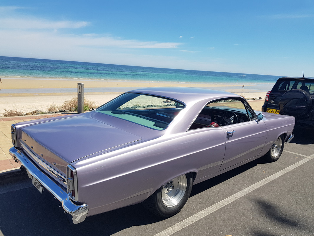

And a pic of yesterdays lunchtime beach swim outing. Just 'cause pics are good.
