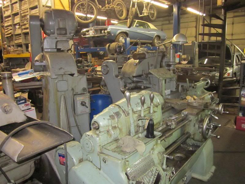

    The adjustable pushrod tool was the first project on a "new to me" lathe: 1940 Pratt & Whitney model B 12x30.
