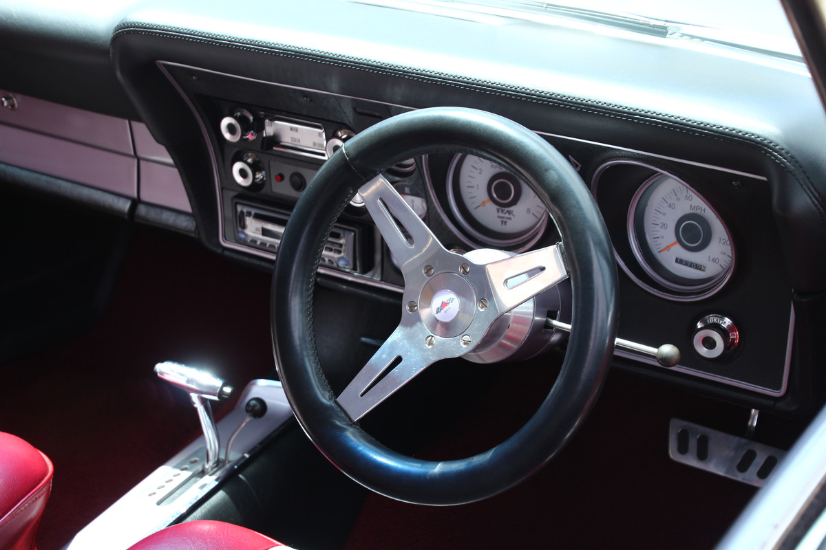

Like Rory I hate cable shifters, hate the 'GM' detents and wanted to retain the console. So as per the picture below I made my own detent plate with a sliding detent that locks the shifter in the forward gears. So 1-2 is a 'slap' shift against a stop, no button necessary. 2-3 is a button down shift against a stop. The lever is then pulled which drops this stop and allows you to shift into neutral and its the normal function then on to P. Of course the lever is pulled when going the other way to to drop it into D from N. Can all be done with one hand.
