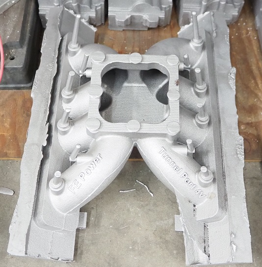

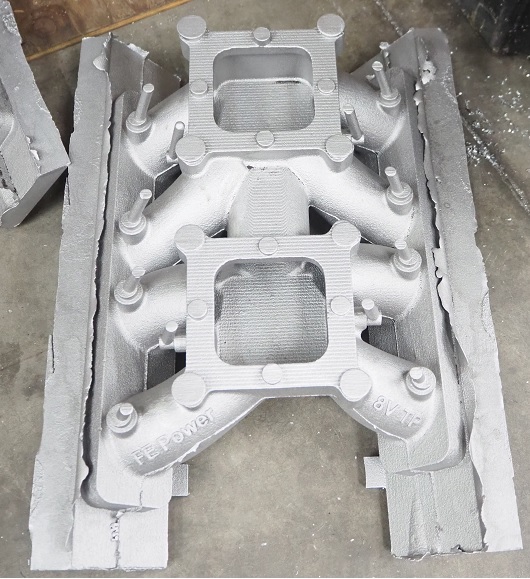

These are intakes I designed to work with my tunnel port cylinder heads.  They bolt onto the tunnel port intake adapter that fits my heads.  Both my heads and the intake adapter have a port that is filled in at the bottom, resulting in a D shape.  This port shape is carried into the intake manifolds as well.  Pictures of the raw castings for the 4V and 8V versions are below.  It will be 4-6 weeks before I get to start machining these; I have a few intakes for the FE Power cylinder head package to machine first, and then a new batch of tunnel port heads, before I can get to these.  I will post more pictures of these after I get them machined and ready to bolt on.

Those look real nice Jay. Awesome casting
