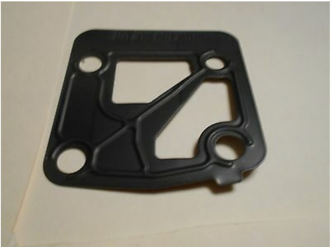

Ford also had a rubber coated embossed steel version available, it’s part number D3TZ-6A636-A. I put an Internet picture below. The oil passage holes are shaped a little different to match the pickup truck oil adapters. I think I have one around here somewhere, but can’t find it at the moment, I was going to try holding it up to the typical car oil adapter and see if the passages work, but can’t verify right now. I don’t know if these are still available at the dealer, but again seems there are a bunch out there.
Here’s the D3TZ-6A636-A for those interested.

Thank you for posting that. The embossed would  be ideal.  It would help make up for any irregularities.

I found the gasket if you can verify it will work with the passenger adapter.

I haven’t been able to dig up one of the D3TZ embossed ones here to verify how the holes line up with the standard car adapter. I know they’re kind of spendy, so I hate to recommend it off hand. Hoping maybe someone else here on the forum had one sitting around who could check too, apparently not. A lot of people probably don’t even know that one exists.

Thanks. I found the paper gasket at Napa. I like the embossed gasket if they work.  The reproduction housing uses the performance version that has the passage openings cut to match the adapter opening. The thick paper seems to be oil saturated.
