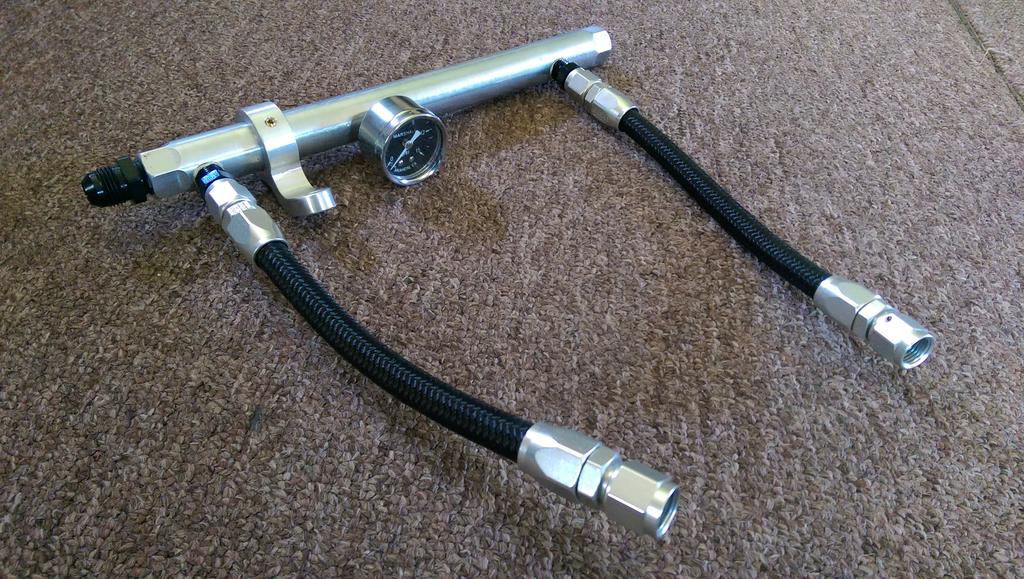

« Reply #12 on: April 10, 2019, 10:24:28 AM »
Here is the setup I am going to run with my electric pump. 1/2 inch hard lines with 8an braided for both supply and return. Haven't run it yet but hopefully will know in a month or so. Jim
