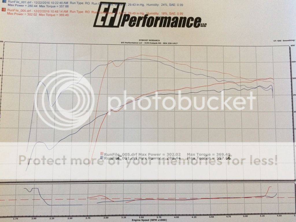

Ran the car today on a DynoJet just to get a baseline.  Basically, I'm not really happy with the way the car pulls but I've been playing with the tune and can't really seem to get it much better.  Last night I pulled 2* of timing out of it to be safe and hit the dyno this morning.
390ci
Holley 750dp
Performer RPM
Edelbrock heads with light bowl cleanup
Comp 270H 224*/.519" on a 110LSA, installed at 106
9.5:1
FPA 1 3/4" TriYs
So, it peaked at 302hp at 5400, 369ftlbs at 3500.  As a reference, made 280hp with 3* less timing in it, and sounded and drove a ton lazier so big difference.
Numbers back up how it feels in the car, it's a torquer around town, kind of surprised it made peak power at 5400 as it feels flat after 5000rpm.
Flywheel numbers, which I'll estimate since I think guys are more familiar, would be 380hp/460ft lbs using 20% loss. I figure my setup, optimally, would make 400hp on an engine dyno, throw exhaust on it I guess this isn't too bad.  Not sure I'd believe 460ftlbs as I don't think any similar builds come close to that number.
If you read the AFR chart though (the dotted red line is 12.5:1), car is tuned fairly well on the hit, but then goes dead fat until 4200rpm or so.  That's about how it feels if you roll into it in say 3rd gear and it has some gear to work against....very soggy.  The peak A/F ratio at peak is perfect so not sure I'd mess with the jets, just not sure how to lean it out before that point?  I don't think a lower power valve would make much difference as this is WOT and I'd think vacuum drops immediately.  Any ideas?

I answered on the FE Forum, but I think you have WAY too much pump shot.  I think the sensor was out of limits and you bathed it hard and it took a lot to clean up.
Which pump cam and shooters, and is it a 50 cc rear pump?

Just 30cc front and rear, pink cams.  Believe .031 shooters front and rear.  Think I'll try a .028 front?
If punched in first or second it'll take off clean with the deep gear in the TKO, but feels lazy in third.

What gear were you in for this dyno info? I think if you were to record the AFR from a pull in 1st, 2nd, and 3rd... that would give you some useful info to look at. If 1st and 2nd are pulling really strong, but in 3rd it feels like it just falls on its face, maybe it's a bad gear combination with the final gear ratio. An engine doesn't completely change behavior just because you shifted into another gear. If you're seeing hesitation in 3rd gear and it has to do with your carb setup, I'd be looking for that hesitation in every gear. If the carb is flooding the engine above 3,000 RPM, that means the high speed circuit is too rich, which would impact how the engine operates regardless of gear. Same if the carb is flooding the engine below 3,000 RPM, except that this would be the transition circuit.
If you post what TKO you have, your final drive gear ratio and the exact size of your rear tires (###/## R 1#) , I can put that info into an excel and share the results. It might reveal something about your shift changes that could be useful. If the shift dropped you into a bad spot on the power curve, that would make the vehicle feel sluggish. And looking at your torque curve, you do have a not-so-ideal area where it drops off a cliff. It looks like your transition range goes dead rich, which makes me think your low speed or transition circuit isn't setup well.

It was in 4th for the pull, I think 1:1 is pretty standard for chassis pulls.  It has a short 3:27 first gear, with second also being fairly short, so I think its a matter of it pulling quickly through the rpm band so I don't feel the laziness in that 2500-4200rpm band where it's so rich.  Carb isn't rich above 4200, it pretty much falls into perfect AFR.
TKO 500 is 3.27/1.98/1.34 with 4.10 gear and 28" tires, bit of a jump to third but with the torque curve being so low, I don't think it's any kind of gear issue.  It actually feels pretty good if banging through the gears as it doesn't dip into that rich region, more rolling into the throttle at say 2700rpm.  I think the way I stated it above it made it seem like I was saying it was lazy when I was shifting up through the gears, when I meant pulling from lower rpm in third.
I do want to get that big dip in the torque curve out, it's losing a ton down low obviously.  Right now even with a peg leg rear it's not too badly "traction limited" unless you wind it up a bit and drop the clutch, I'm thinking it should be able to spin the tires from a roll if the carb was tuned better.
« Last Edit: January 04, 2017, 10:23:37 AM by chilly460 »

Your main circuit looks to be fine, it's the transition circuit that's killing your engine. It shows in the AFR table, as it levels out to a good AFR around 3,000 RPM which is when the main circuit takes over. Which could be the accelerator pump, but it could also be the size of the idle jet.
