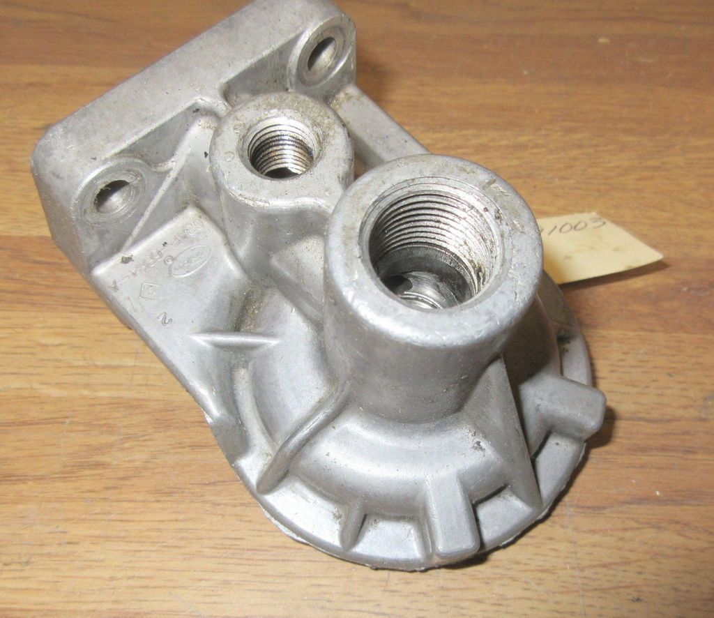

Back when these engines were new Ford had an oil filter adapter on some 427's that had 2 ports, one for the oil pressure sender and one for an oil temp sender. The originals are rare and expensive. Here's a picture ( not my part, picture from ebay ):
There are FE parts suppliers that make modern copies of the dual port oil filter adapter, here's a link to one:
http://stores.precisionoilpumps.com/fe-ford-390-427-428-billet-oil-filter-adaptor-dual-port/
And nothing wrong with doing a "T" fitting like Drew posted, that's also probably the least expensive method. Common for race cars to weld a fitting or bung to the oil pan for the oil temp sender, but you can do it from the oil filter adapter or T fitting also, especially if you are using an electric gauge with a compact sending unit.
