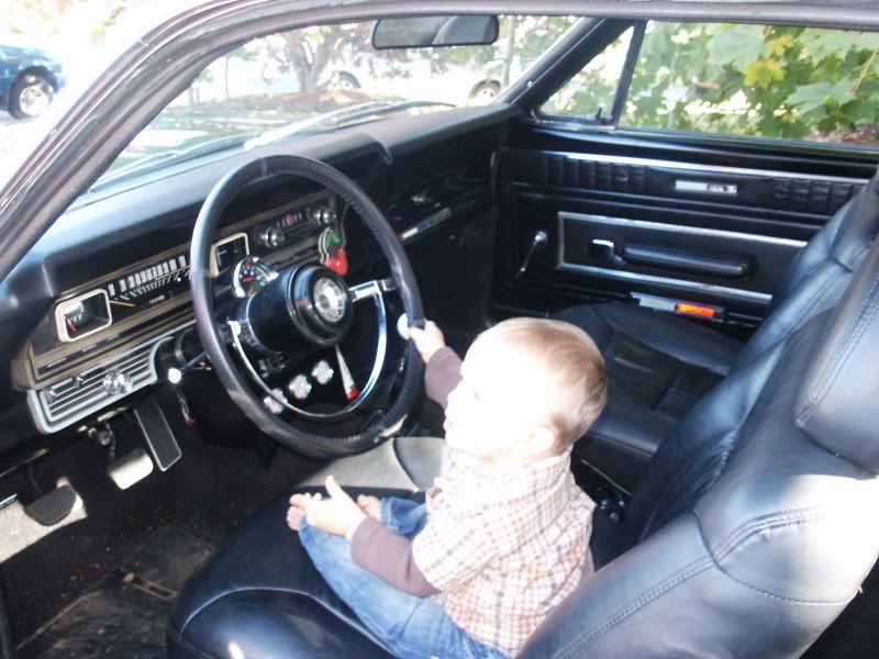

This what I did Rod.
I spent many hours looking at seats on the spider web.
Found a set I liked and had them shipped, well I had to pay for them too. Go figure?
I then had to figure out a plan to mount them. I used 1" square metal tube and fabbed up a frame that fit the seat
and the floor pan. At the same time I also ordered up some 3 point belts and had to make a fancy nut for the upper B mount.
The plan seems to have worked, they are very comfy and have held up very well for many years.
My Grandson testing them out about 4 years ago. He starts school this Sept.  ;D
FYI You could get a 67 XL Fairlane with a bench or buckets.

Thanks Howie, looks nice. The Falcon Sport Coupe had buckets as an option as well as the XL Fairlane. I'm thinking OE buckets would be too pricey for my budget and will look into some of the more common/newer Mustangs. I may get lucky and stumble on a set of Falcon/Fairlane buckets,  ;D, RodC.
